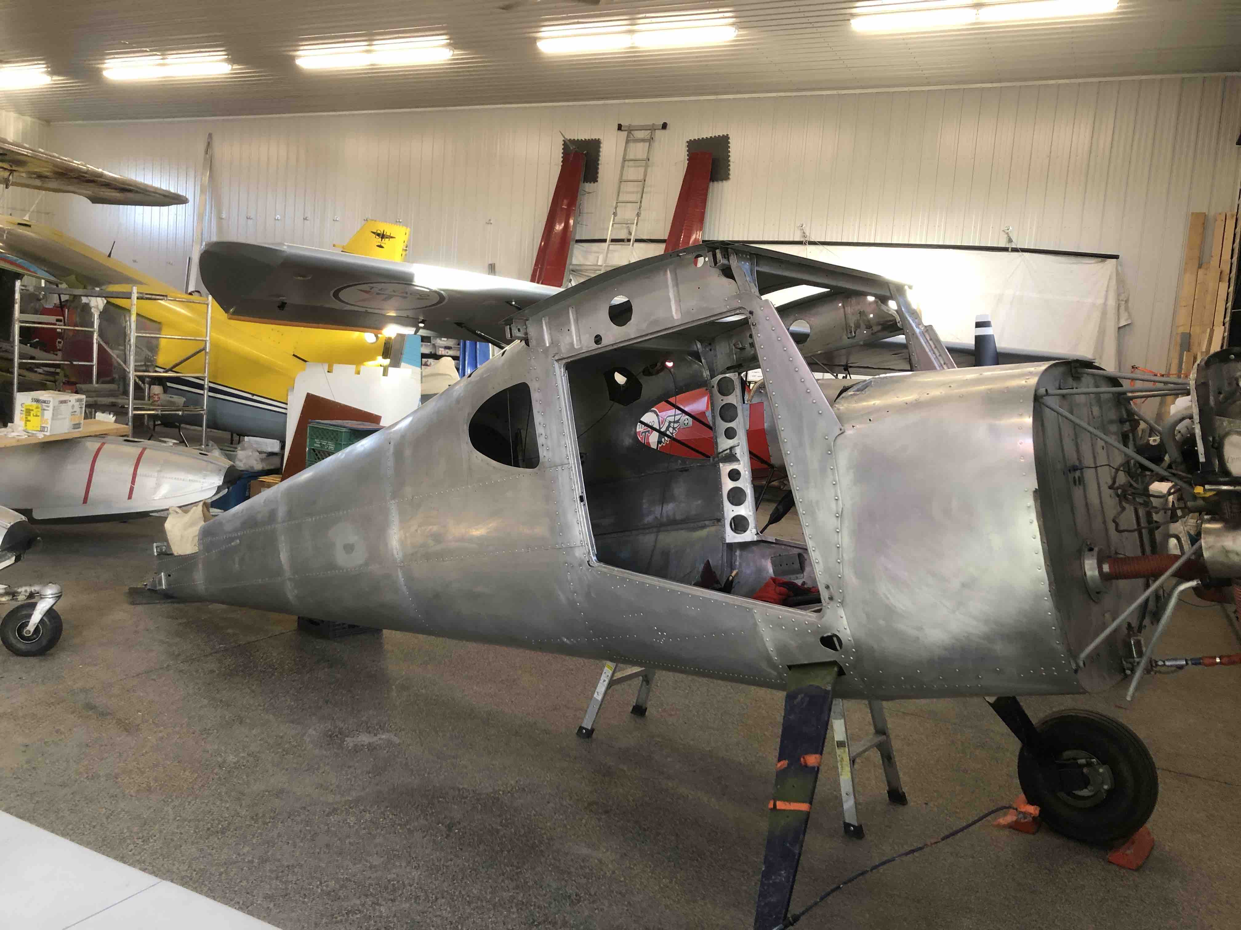

I recently used what was available at the local auto parts dealer: CMA’s Aircraft Stripper
link: https://www.abexpress.ca/PROD/CMA-AIR001
I tried another one... i forgot the name... but I didn't like it. Result can change with the type of painting you got on your fuselage.
Temperature above 15°C is really important.
I was using some saran wrap to help the chemical to do it's job on some parts...
Turco is another good brand.
Here is my fuselage.
I'm not planning to do a lot of polishing but I'll wash my airplane regularly
- IMG_2104 copy test.jpg (409.39 KiB) Viewed 5240 times

Re: Removing all paint and Polishing the Aluminum
Paint
Pro:
1. Additional protection: can help to prevent erosion/corrosion
2. Cosmetic & personnalisation
Cons:
1. Cost of paint/painter (~5k USD)
2. Extra weight (~15 pounds)
Polished
Pro:
1. Save weight (~15 pounds)
2. Save time & money if you don't polish your airplane (just strip the paint)
3. Easy DIY project (if you know & A&P for parts removal/installation)
4. Fuselage is easier to inspect
Cons:
1. Need to wash &/or polish your airplane regularly (remove corrosion and scratches on the surface)
2. Extremely time consuming for polishing... especially if you want to go glass mirror
3. You might need to replace some structural portion hidden under a layer of putty... $$$
Pro:
Cons:
Polished
Pro:
Cons:
Mat | CSG3
