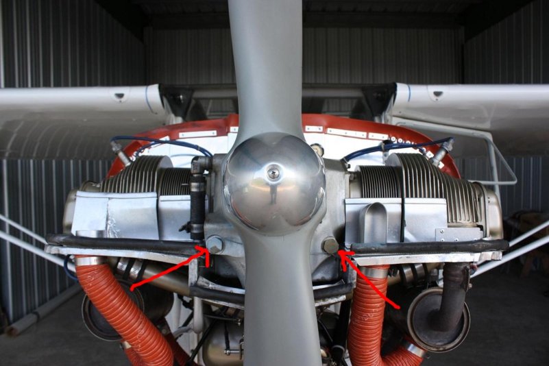

- Posts: 560
Re: crankcase breather elbow
Anything like these useful? My 0-200, don't know the story on the 85's
