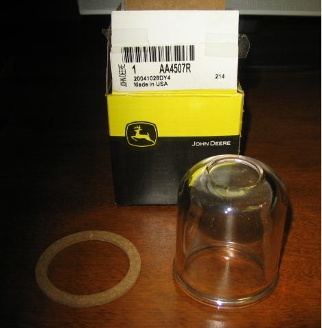

I saved this picture a while back from previous forum, John Deere Gascolator. Would the gasket be appropriate for the fuel gauges??

Thanks everyone. I actually have a gascolator gasket in the hangar and I'll give it a try tomorrow. If not, Tractor Supply, here I come

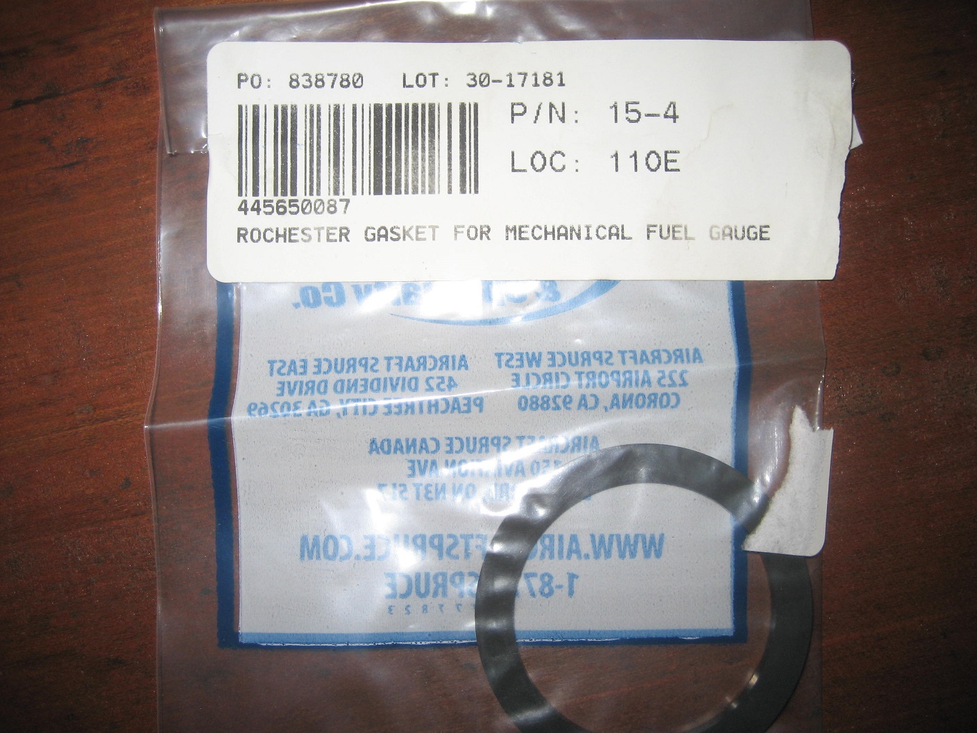

These work pretty good, too (Pg. 603, AC Spruce Catalogue): Gasket for 05-16700 ........................................P/N 15-4 ................$3.65

Re: Fuel Gauge gasket
8170 wrote: ↑Mon Jul 16, 2018 1:55 pm I was actually going to try and laser cut my own out of cork. I will let you know how they turn out.
It'd be neat to fab as "owner supplied" part I guess...but, can't imagine why one would go to the trouble with the OEM type BUNA gasket available from Spruce for less than $4 bucks ;) .(Attached is shown installed on OEM gauge - fits/seals perfectly)
