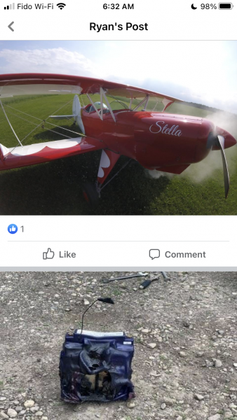

There is few EarthX batteries that got overheating issues...
It might be a good idea to install a BMS with an over-voltage protection
Mat | CSG3
