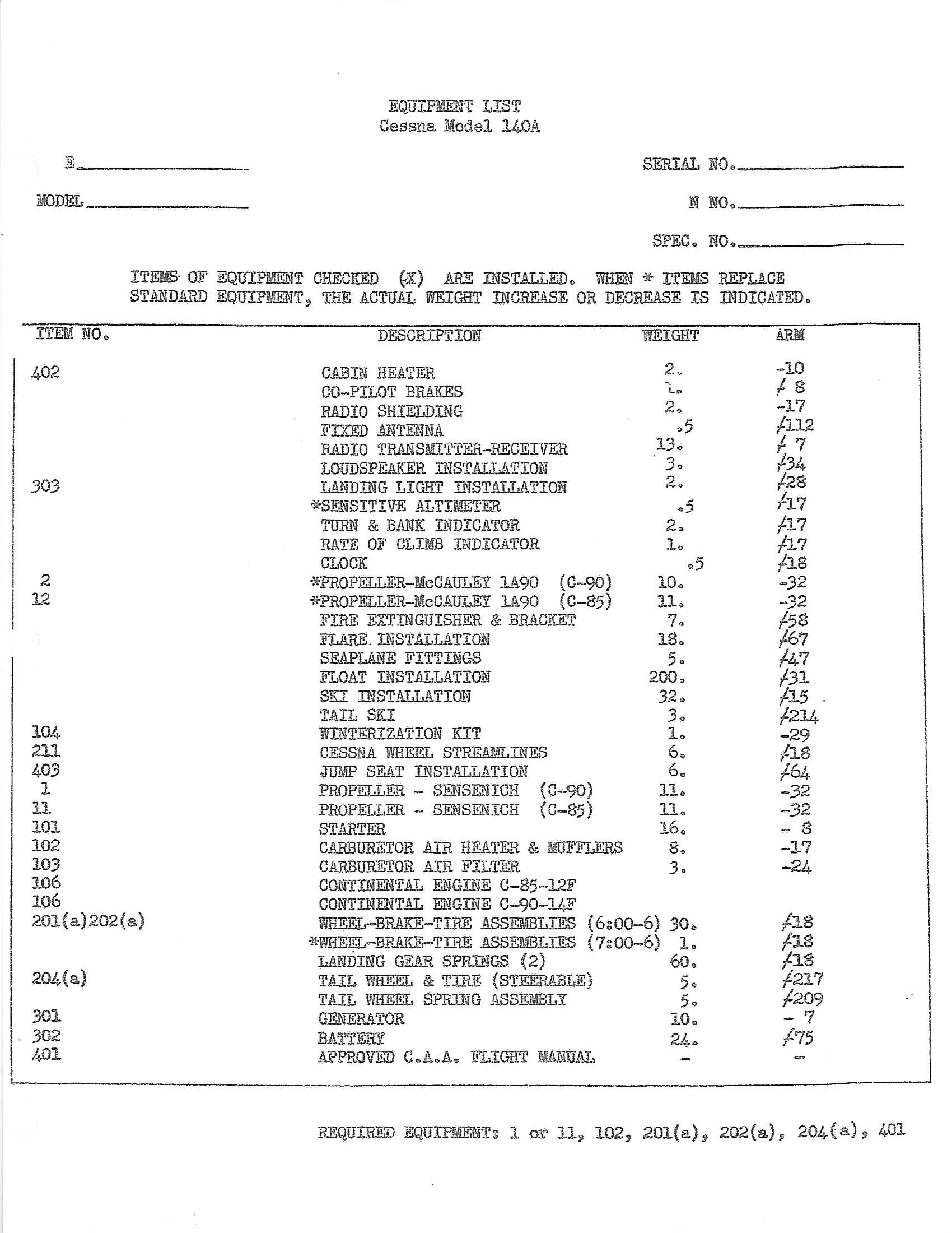

Received the 140A Equipment list (EL) and Weight and Balance from Textron this morning. They provided "blank" EL and W&B forms for the 140A AND the original EL and W&B for my plane as it left the factory. There was a $125 fee, but well worth it since I didn't have the data available.
Here's a copy of the blank EL.
C140A Equipment List.jpg (375.28 KiB) Viewed 3913 times
There are some items in the TCDS that are not included in this list.
By the way, my 140A original empty weight was 962.5 lbs w/o oil. Only optional equipment was metal prop, radio, cabin heat, landing light and recording tachometer(+28 lbs). It has gained 40 lbs over the past 71 years!
