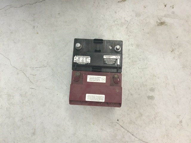

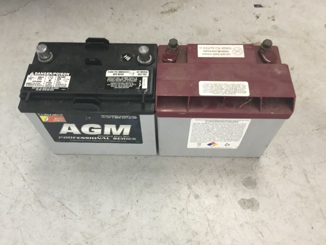

As a funny side, a proper AGM that fits in an early model Mazda Miata just about can’t be found anymore, but a Concorde RG-25 is a perfect fit if you change the terminals on the cars battery cables.
This os a Mazda battery beside of an RG-25XC. I ordered an Odyssey 925 and may put it in the Cessna and the Concorde in the car.
