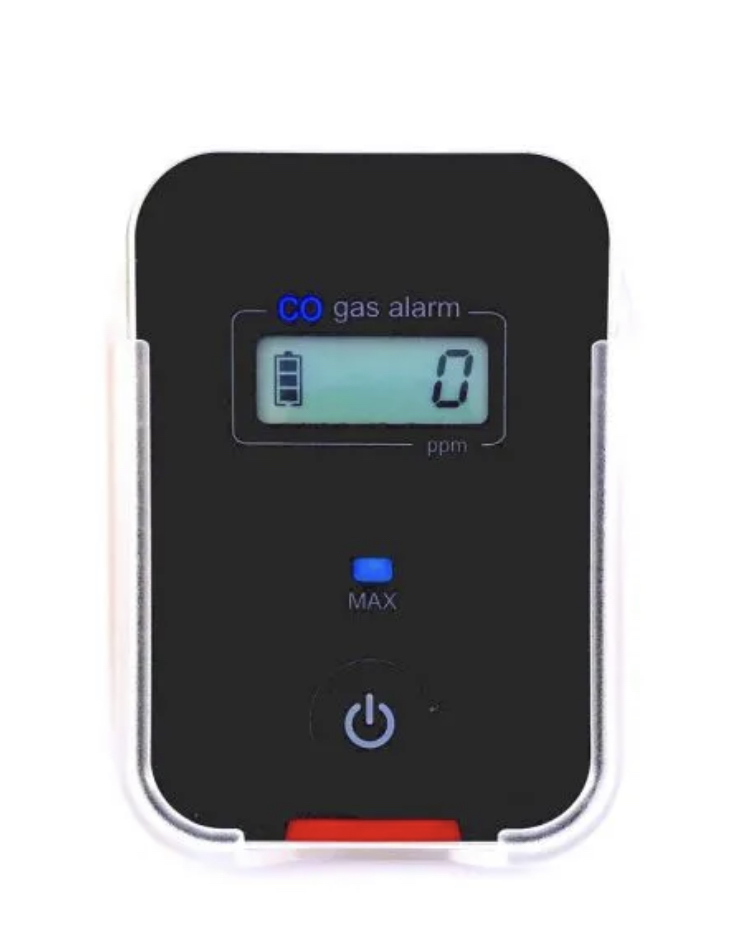

Bought a sensitive digital detector (from sportys) that is pretty close to the sensitivity of the expensive one I borrowed (Fluke) to chase down where the leak/problem areas are. Figured with those 3 CO detectors ( one on each doorpost and one on panel) they would have changed color even on 3 hour flight. Anyway I’m panel mounting a digital indicator on both our planes. Winter flying with the heat on all the time demands it. It was funny today we took the digital indicator out on a flight in our PA-18 and I figured it woulda had some indications being how drafty a Cub is anyway. Some mods like belly pods and such direct exhaust tainted airflow to windows and door gaps.
In flight zilch nada nothing the only time it got elevated was at the hold short line parked next to three planes even then it was only 9ppm. Funny how a few local pilots say I’m overreacting about a “little” CO that doesn't trip the tried and true spot indicators. But then again none of them have been in the hospital with bad CO poisoning.

Were you able to track down where the CO leak was coming from? I just installed a new C-150 exhaust system and I am still registering some CO on my digital detector. It seems to be the worst during climb out and approach to land. At Cruise the levels are low to none. I've looked for leak points in the firewall but nothing is sticking out. Just curious if you found something that I am overlooking.
2356
- Posts: 143
- Name: Huey Pilot
- Location: Gainesville, TX
Re: CO indicators
Two leak points come to mind. The hole where the fuel line exits the firewall. Where the firewall attaches to the fuselage is not air tight. How else would oil migrate on the floor below the rudder pedals.
