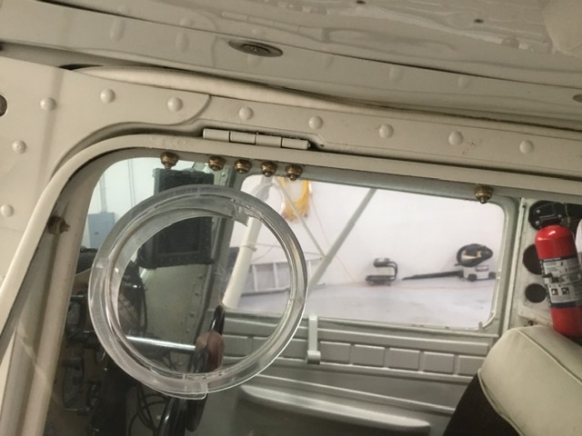

I used counter sunk screws and self locking nuts
- 676876D1-BD9F-42FE-9868-B7F711FE3831.jpeg (81.57 KiB) Viewed 2680 times
