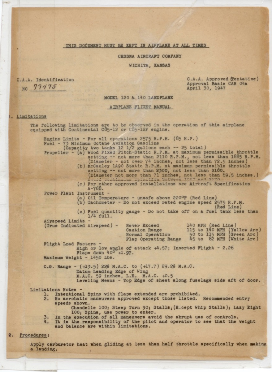

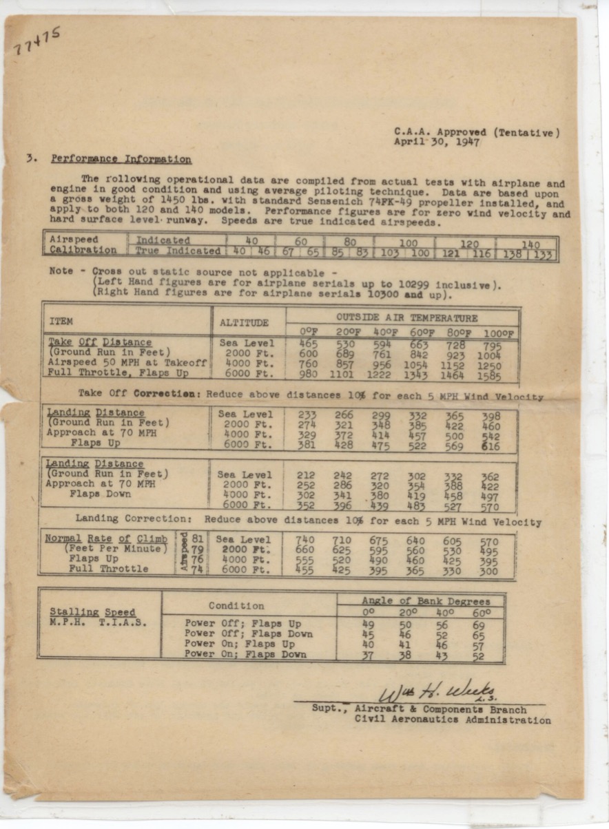

I forgot that my own AFM is marked with a Tentative Approval. Per the TCDS, it is acceptable for aircraft up to and including the 1947 model and I also noticed it actually has more info than the Final version. I am attaching it here it case it helps. Mine was from April of 47 and the final was in March of 48 with 2 different approvers as well.
- N77475 Orig Flight Man.jpg (246.09 KiB) Viewed 5180 times
- N77475 Orig Flight Man pg2.jpg (240.43 KiB) Viewed 5180 times
