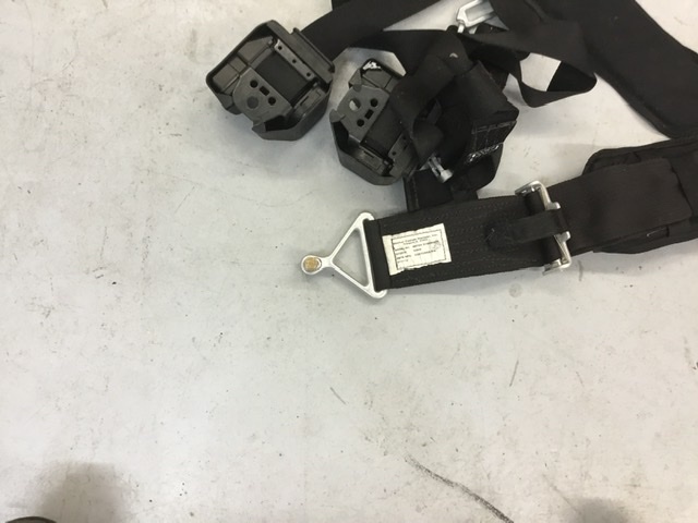

Do you have a picture?
This is what I have now, there were a bunch of them were I worked, went on some kind of Aero Commander aircraft so I put them in the 140 as the ones in it were old as Methuselah a who knows how weak they were.
they are standard aircraft seat belts with a 1500 lb rating.
These are the Hookers I have that came off of a new Thrush, some idiot wanted the Amsafe airbag belts. Ag aircraft are required to be fitted with a 5,000 belt and the pilot is required to wear a helmet. So these and I assume other Hookers are 5,000 belts.
The Amsafe air bag belts are not 5,000 belts, the FSDO that approved the Amsafe belts was unaware of the 5,000 lb requirement
Anyway take a 250 lb pilot and restrain him with a 1500 lb belt, he will equal that in a 6 G crash which isn’t a big number in a crash.
But after sitting in the sun for 10 years or longer, what is the strength now?
So I’d like to put in at least the Hooker belt I have but don’t know how to attach it.
