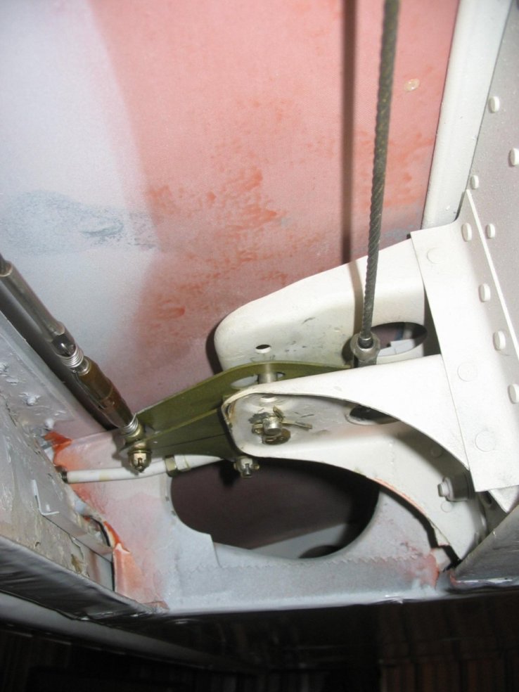

The aileron rods are supposed to be bent, here's a pic of one of mine, a little hard to see. Can't answer the slop question till I get to the hangar....

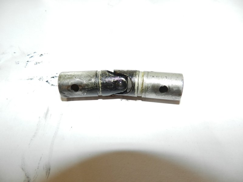

Be sure to check the u-joints in the control tubes -- some slop can come from wear there, plus if the tube "guide balls" are worn it can increase "sloppiness" feel. Mac

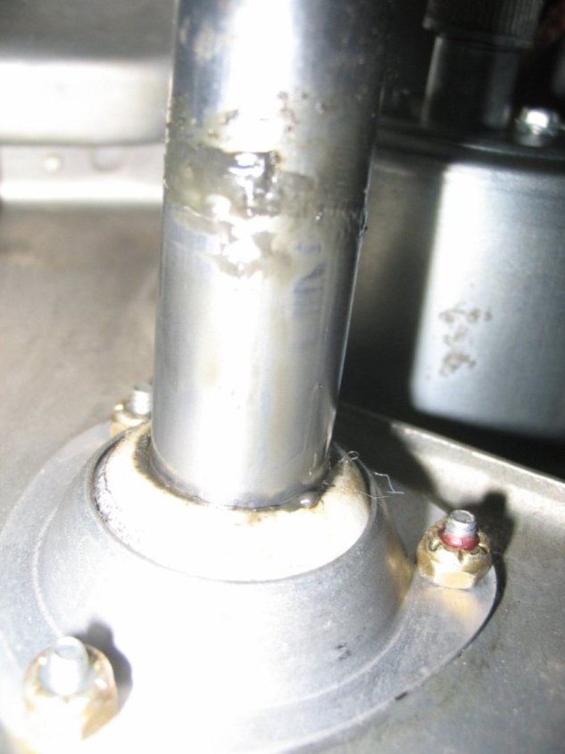

u-joints under panel... new boot covers from McMaster-Carr replaced the old ones...
Control yoke teflon ball (from back of panel)
