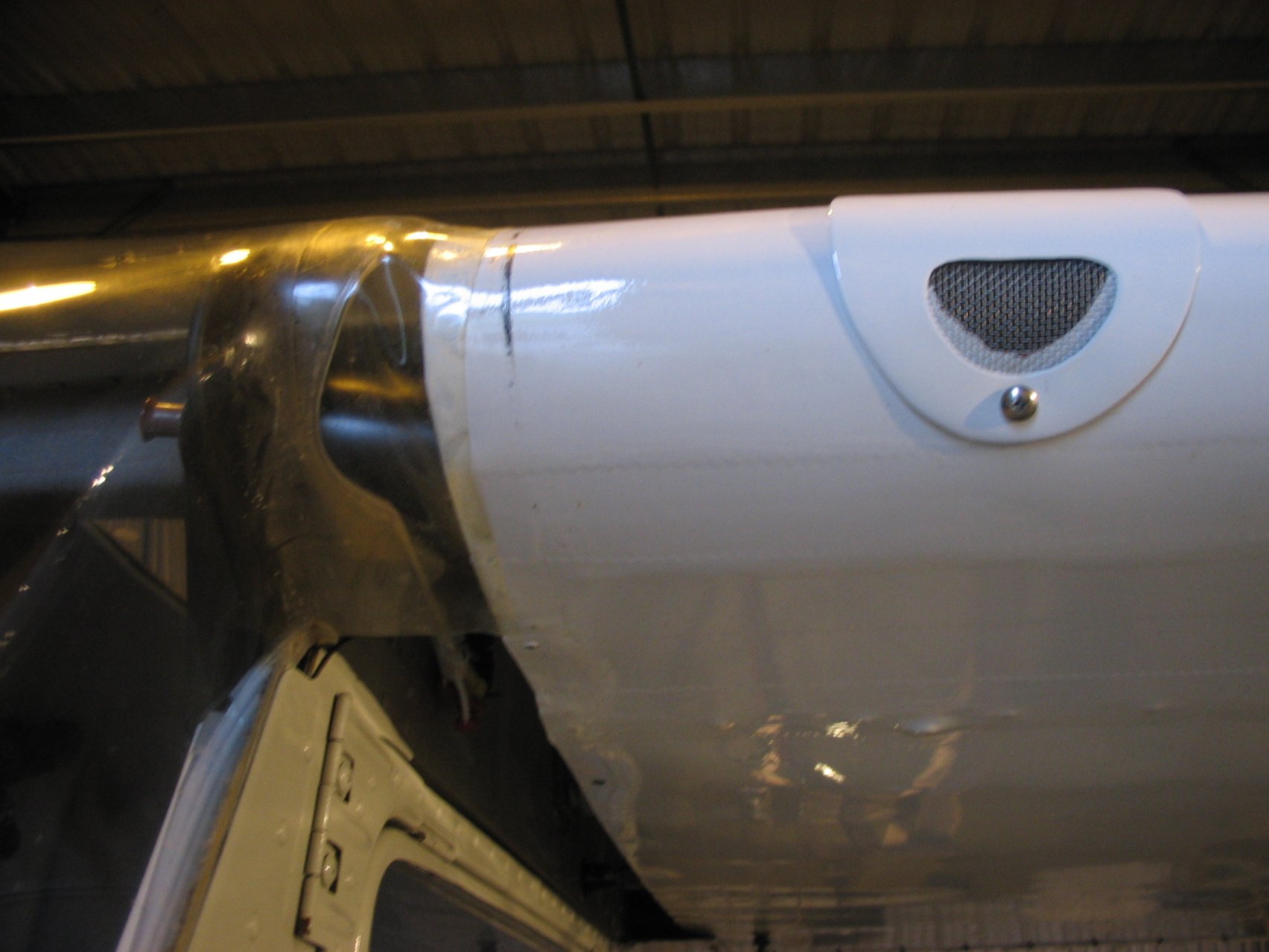

- Posts: 562
Re: Stopping (cold!) airflow around the wing root vents.
I had a wide piece of clear prop tape I used behind the wing root fairing, seemed to help...
- wingroottape.jpg (200.58 KiB) Viewed 3560 times
Just for follow-up. I used something similar to the last post to bridge the gap between wing and windshield. Not as wide as what you used so had to overlap it. Helped a lot but still too much leakage. So I cut some foam padding from an old seat to shape and stuffed it into the open space around the vent. Then the old aluminum piece would no longer fit so I cut them off and custom made some panels and covered them with vinyl material matching the interior. Cosmetically looks pretty good and cured the windstorm in the cabin!
One thing always leads to another. Now that the major source of cold air is tamed I can feel a lot of leakage around the windshield itself, especially across the top. Working on that next. I'm thinking some kind of clear tape.
