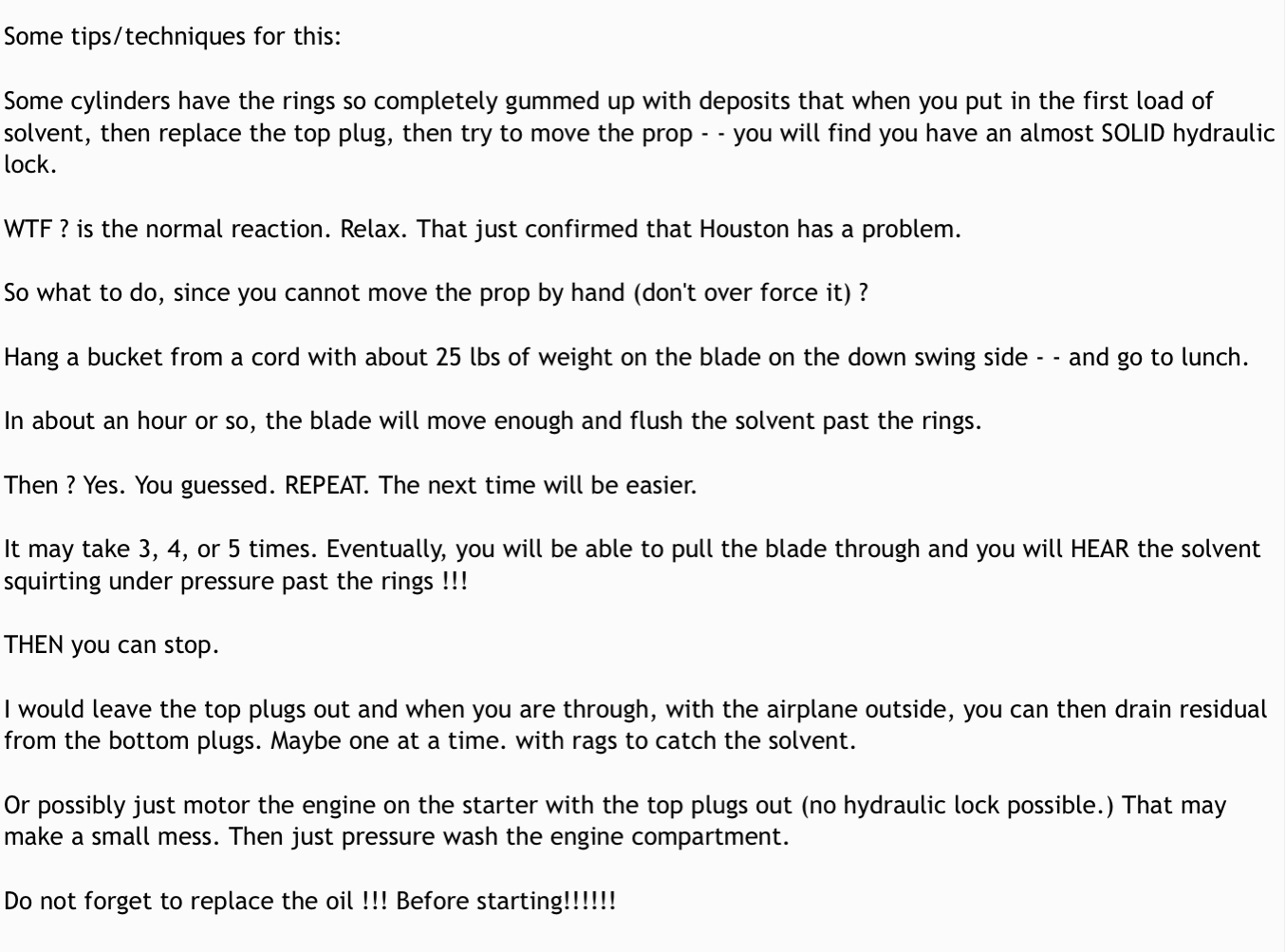

If you think its rings I've heard a solvent flush in the cylinder may free things up.
The best written description I've seen for the procedure is this form post:
https://www.beechtalk.com/forums/viewto ... 2#p1997662
As for what solvent to use, I've heard most people just use MMO.

Here’s a screenshot. Continental engines tend to leak compared to Lycomings. If it’s making rated power and not showing signs of distress I would fly on.
