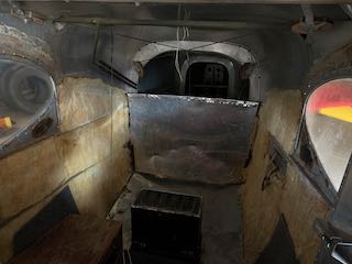

I misspoke, it was not an STC but a 337. Attached are some pictures.
- IMG_2019.jpeg (46.53 KiB) Viewed 8241 times
- IMG_2021.jpeg (66.09 KiB) Viewed 8241 times
