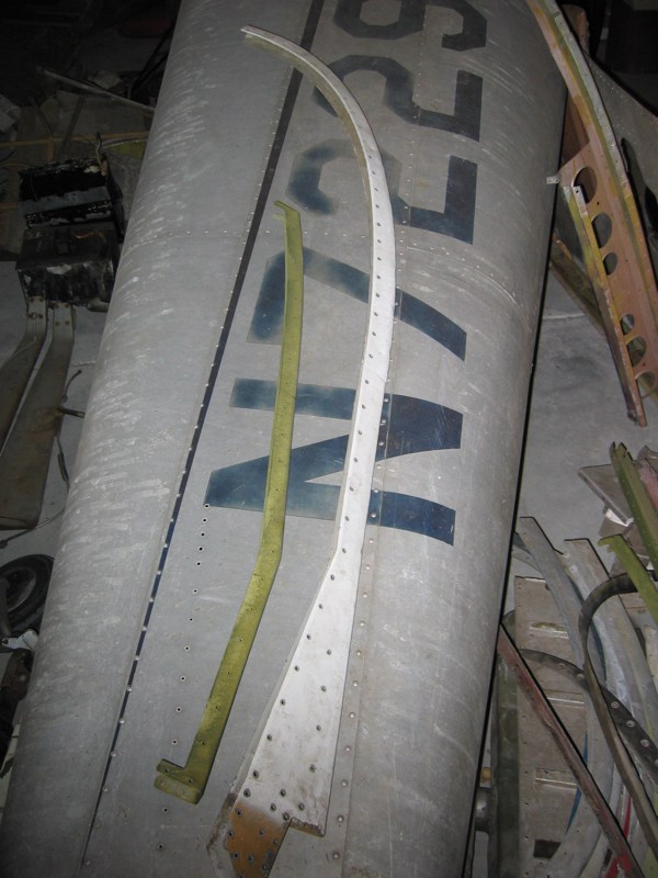

I'm not sure if you are confusing the leading edge reinforcement for the stabilizer or the elevator spar reinforcement AD, hope this helps.
Stabilizer leading edge reinforcement....
channel and leading edge.jpeg (98.23 KiB) Viewed 2823 times

Thanks for the pictures. Where would I find this "extra" or out of place" rivet I'm supposed to be looking for?
