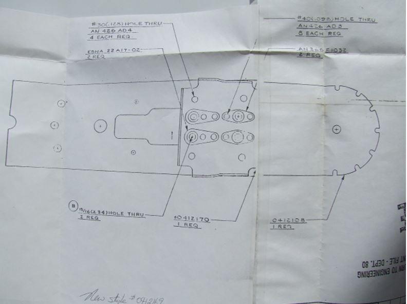

While I am deep into a restoration of my 140 I would like to add the doubler to the rear fuselage bulkhead to eliminate the recurring AD 47-52-02.
Univair wants and insane amount for one.
Does anyone have a pattern I could use to fabricate one?
Thanks,
Fuselage rear Bulkhead doubler

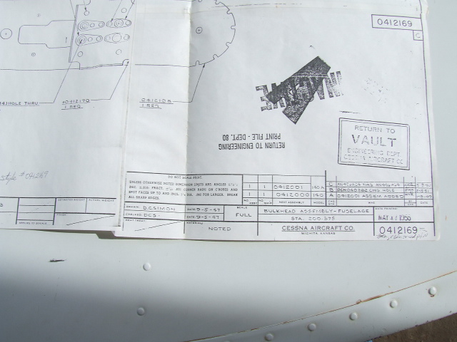

Re: Fuselage rear Bulkhead doubler
This is the Tailpost with the doubler in question.
- Posts: 562
Not the best quality but all I've got...
- rearbulkheadADfix2.JPG (63.77 KiB) Viewed 4385 times
- 0412169%20Tail%20Post%20Reinforcement[1].JPG (39.23 KiB) Viewed 4386 times
- Tailpost 003.JPG (113.78 KiB) Viewed 4386 times
That helps.
I can make it with that.
Thanks,
Thanks,
