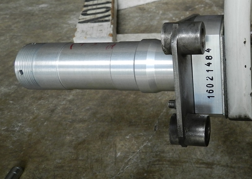

I am restoring a 1947 C-140 and have purchased a new set of Cleavland wheels and brakes. I tried to mount the brakes today but the fitting that holds the caliper assembly holds the assembly 5/16” away from the rotor. The fitting is mounted between the gear leg and the aluminum axel. What am I missing? The axel nut screws on to where there will be no problem getting a cotter pin installed. Will I need a different axel?

Try turning the torque plates around?
- rtaxle2.jpg (297.55 KiB) Viewed 5647 times

I may not understand your issue so my suggestion may be worth about as much as what you paid for it, but have you tried to actuate the brakes after assembly? I found that there is a gap between the pad and rotor that takes up once you apply the brakes. I just went through this a couple of weeks ago after changing a flat tire.
That may not be your issue but thought I would throw it out there

The picture David placed on the request made all the difference and the plane is now on its gear, the first time in over 40 years! Yesterday I completely disassembled the control column, removed all 72 year old hard grease and dirt, oiled, painted, and reassembled it. Sure glad I took several e pictures before I took it apart! This plane had been converted to tricycle gear back in the 60s and then used hard and put to bed wet. I am returning it to the way it should be. It will never be a show plane but it will be a very solid clean airplane. This is number 23 of the planes I have restored. My last one was a Bucker Jungman.
