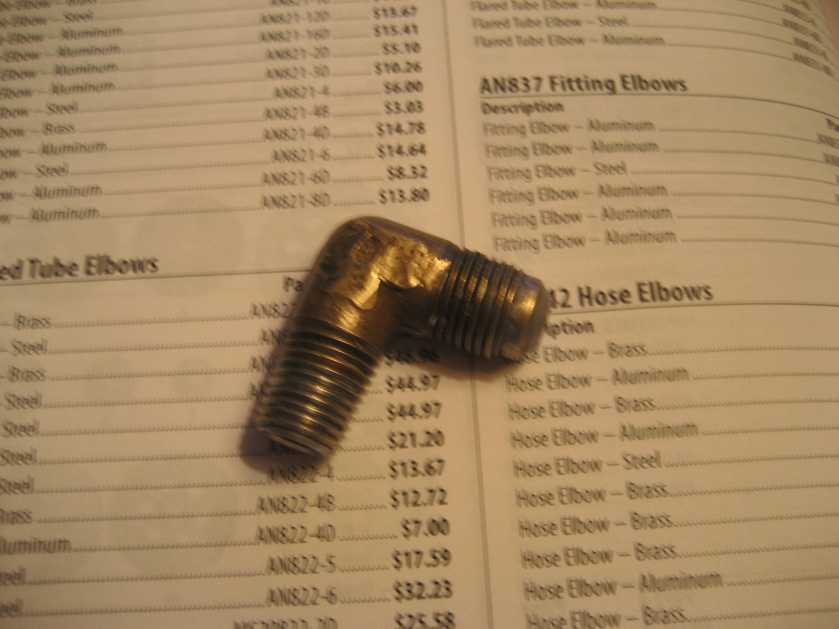

BRASS VS. ALUMINUM (STEEL?) FUEL FITTING?
The parts catalogue specifies a AN822-6B for the fuel line-to-carb (Stromberg) connection. Mine is the OEM brass, but needs replacing. ...wondering if it's safe & "legal" to replace with aluminum or steel equivalent? With a quick search of the usual suppliers I'm not finding the brass fittings...except for a used one being sold on Ebay as a "collector's item"

Can we read between the lines and note that "collectors item" means "lotsa moola?" As in grandiose price tag? I wouldn't recommend aluminum, I went with steel for mine. I like the additional strength. Make sure you get the proper Aviation flare end.

Brass and steel are equivalent. Aluminum is not an acceptable substitute. The brass part would have been AN822-6 (no letter after.) AN822-6S (was) is the steel equivalent. The "modern" part number is MS20822-6. ECAS says that would be steel.

Thanks again, all! I've got a new steel on the way from Spruce. My IA "approves" so probably will just go with it. Mac
