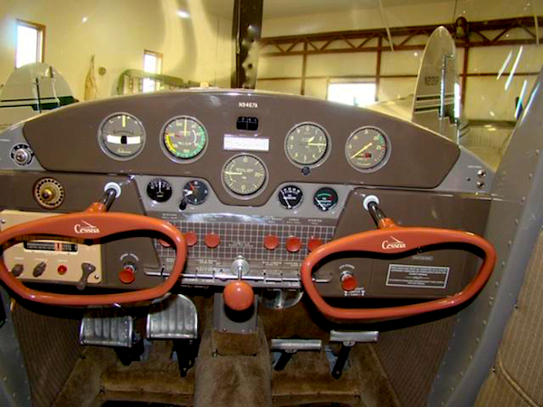

Lorraine Morris confirmed Dark India as a brown. She also sent an original paint and instrument set up for a 1949 which was laid out the same as 1948. See the picture below. VERY HELPFUL, although I have to admit, Cessna's choice of colors for their red-trimmed Cessnas seems kind of bland (if my wife ever sees me trying to wear greys with tans and browns, she frowns big time). But this is what it must have looked like.
Good news is my panel has this exact layout on the main instruments,. Now the last remaining question seems to be the optional instruments at position 1 and position 8. Mine has an ELT on the left and an EGT on the right.
Lots of work to do on the panel now. Many thanks, Steve

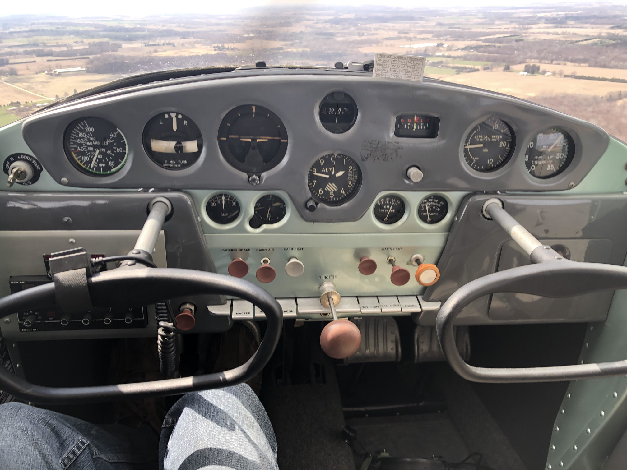

Here's mine. It came new with a gyro attitude indicator and heading indicator. Quite heavy but they still work (for the most part). I'd like to turn my panel back to a more stock look as well. Have to start with a new plexiglass part in the middle....

Love those Gyro and heading indicators! Cool panel. I am guessing by the panel colors that your plane was originally green trimmed instead of red trimmed exterior. Thanks for posting that pic. Steve

To be honest I don’t really know what color the panel was originally!
