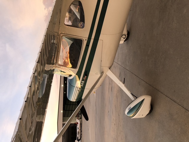

I got through adding ADS-B, an intercom, and bose jacks to my airplane so she is flying again!
