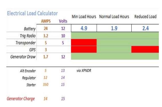

I was wondering what my battery life would be in an emergency and did a little calculation of draw on the battery. Generally - once the engine is started - our little beasts don't have huge amounts of power hungry kit. I think that most have perhaps ( if the IPAD / Tablet ) is not connected to the battery something like this - although I am no electrical bod so I may be barking up the wrong tree...
But what ever is the correct answer even with most of the kit on I think am drawing quite a lot less than I thought I was. Certainly enough less to mean that I would have more than enough juice to wait 20 -30 mins at less than the 1000rpm my generator needs to start charging.
