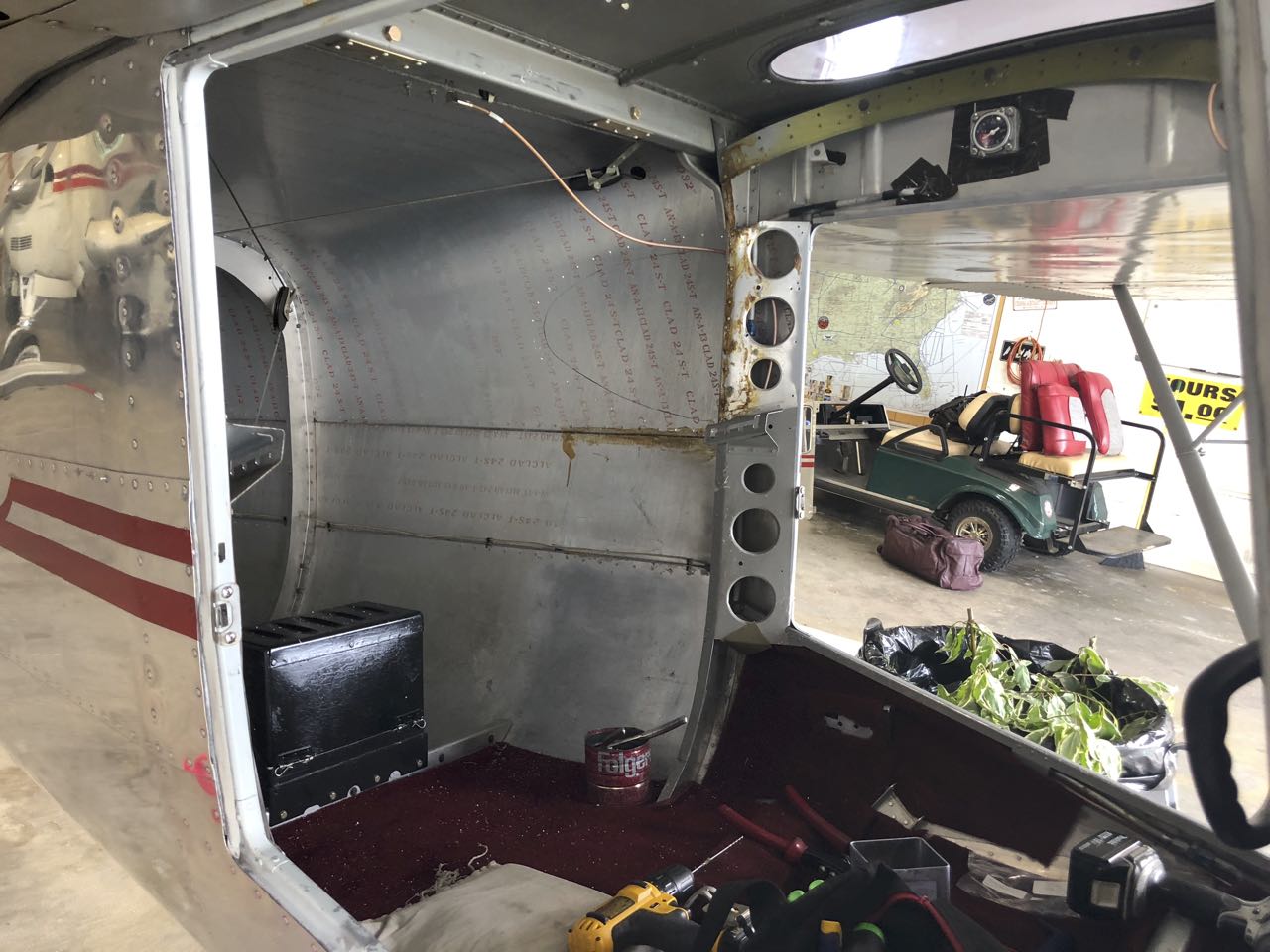

Thanks Mac! Yes indeed, it was like going to a 120/140 university. On the ADS-B, I did a flight check and pulled the report and it came back with no errors. In fact, I pulled a couple of different flights just to be sure.
I snapped some pics while the headliner was out. See if this one answers your question.

David wrote: "... pics while the headliner was out. See if this one answers your question."
It almost does...but it's the actual clearance above the cable and 'twixt it & the aileron bracket(s) & that's not quite in the view in your photo. The small center pulley actually guides the cable and apparently holds it off (down) from dragging on the bracket bottom (I've never seen a bracket that's been "sawed" or a cable that's frayed there, but have heard that it has happened to some over the years :shock: ). I'm confident that had Ken or Lorraine noticed anything unusual, you'd know it. (We should all remember that John Cooper has "many, MANY" of those pulleys & it's probably a good idea to replace them...at least every 70+ years or so. The bushing costs a lot more than John's pulleys, incidentally!). Congrats on the really beautiful "new" plane, David, and on the successful install of ADS-B -- now, you can relax and have a lot of fun "just flying" (The "2020 mandate" has now become a non-issue for you! :D )!

Unfortunately I don't think I have a better picture. Lorraine was in that area working for quite a while and to your point, I'm sure she would of noticed something if it was wrong. One place where I feel fortunate is this plane has an extremely low total time of around 1,800 hours. Lorraine commented that it might be one of the cleanest examples she has seen from general condition and also she couldn't find any indicators that this one has ever been on its back or had other significant damage. Someone has kept this plane in a climate controlled environment for much of its life would be my theory. My records I had pulled from OKC showed NDH but, as we all know, that's never the final word.
Thanks again and yes, It's nice to have the ADS-B mandate as a non-issue now!
