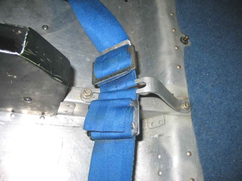

Have never seen a 120 center piece, here's what my 140 looks like if it can give you ideas....

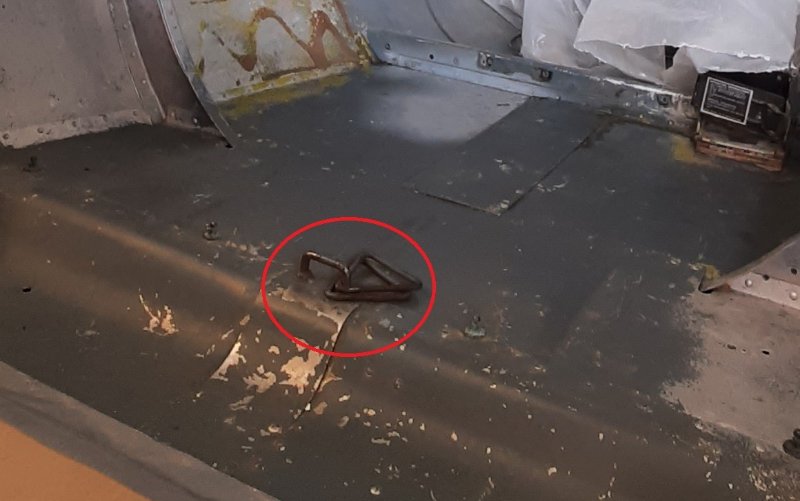

Here's what's currently in my 120. Very clearly not an original part or any STC or AD I've seen.
You can see the cover plate that goes over the spot where the flap control tunnel would be on a 140.

My 120 bracket looks just like the posted 140 bracket. Not sure what/how this one was modified. But if the issue was that the AN3 bolted aluminum brackets were failing at times, not sure how well this setup would fare.
