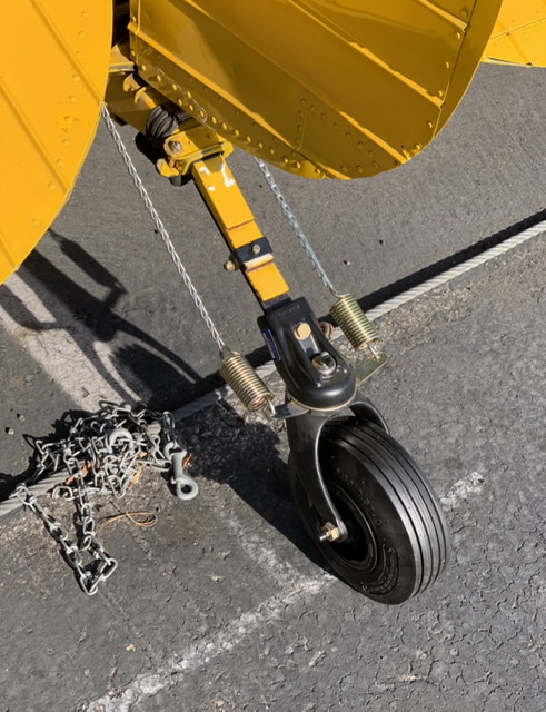

Got the new tailwheel all dialed in today. Had to move the springs to the steering arm so they wouldn’t bang around near the rudder. Also replaced the bottom leaf spring. Can’t wait to take it for a spin!

That's the way I have my 3200 configured with springs on the bottom.

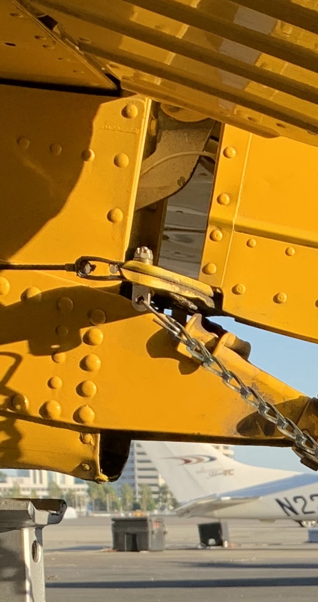

8424 wrote: Mon Dec 14, 2020 3:19 pm Tamer,
Is your chain attached to the rudder horn via eye bolts or the tab that extends from the rear of the horn?
I recently purchased the springs from AirframesAlaska and I was shocked at the size of the springs!
Steve A H
Hi Steve,
Sorry for the delay. Just saw this. Here's a photo, hopefully it helps. I used eye-bolts. FYI the photo is before I installed the cotter pins.
I too was shocked how big the chain springs are!
Tamer
