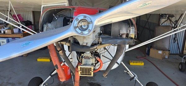

My Sensenich looks pretty bad, even though it is a good prop for around the pattern. I think it is 74-44. The motor is a Don Swords stroker from 2012. It climbs really well with 10 flaps at about 65, but of course 70 is safer. Anyway Image Anyway I would consider replacing the prop with something more modern, if I could be confident it would improve anything.
74-44 prop small.jpg (51.34 KiB) Viewed 4150 times
