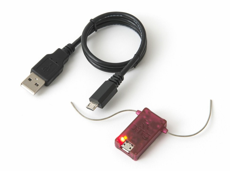

Thanks for that info./update, Steve -- utilizing the skySensor sure seems like a logical "balance". What are you using for your "in" receiver? Does the skySensor provide solid reception? ...kinda related, when I purchased the Ifly740b @ SNF a few years back there was an option to buy uAvionix's "Ping Buddy"* for a dual band sensor. Works great. Unfortunately (IMO) uAvionix stopped making them soon thereafter, so they're seldom available...except used, of course. About the size of a quarter, it's an amazing little piece of equipment. If it ever fails, though, I'd thought that the skySensor would be a good answer in that it doesn't require "sticking" somewhere in the cockpit, is hardwired & doesn't require fiddling with.
