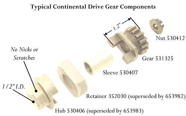

I have attached an email exchange that I had with Laurie from Classic Aero and have attached what she attached in the email. I'm happy I can share this info because when I was investigating alternator kits, I had to do a lot of legwork to try and figure out what was out there; I'll save you that!

Hi Elliot,
Thank you for your inquiry on the B & C 30-amp alternator. Classic Aero sells an STC for the B & C alternator as a kit. It has everything you need to install it. It has wide applicability on all the small Continental engines. We have included the STC cover page and next 2 pages. The second 2 pages list the airframes by make and model. However, page 1 paragraph 5 (as notated) also includes in the STC any airframe that has the listed engines installed. That allows owners who have changed engines on their vintage aircraft to use the STC, even if their Make is not listed.
The generator comes with the generator gear set installed. We charge a core charge on the individual items as follows:
1. Hub 180.00
2. Retainer 22.00
3. Bushing 60.00
4. Gear 265.00
5. Nut 23.00
Total 550.00
Return gear sets to us at:
Classic Aero LLC
2487 S Gilbert Rd. #106-113
Gilbert, AZ 85295
Our customers who already have an engine with electrical system return the gear set to us for inspection. The second attachment is a breakout of the gear set. Please note that the retainer and hub require the newer CM version. We have also included an attachment with a comparison of 2 hub styles that are in use. Only the newer one is acceptable for this generator, so occasionally we must reject the old-style hubs.
Customers who are adding an electrical system can either procure and provide to us the components or opt to buy the alternator and pay the core charge.
The price of the alternator with STC is $954.95 + core charge (if applicable) and $15.00 shipping.
