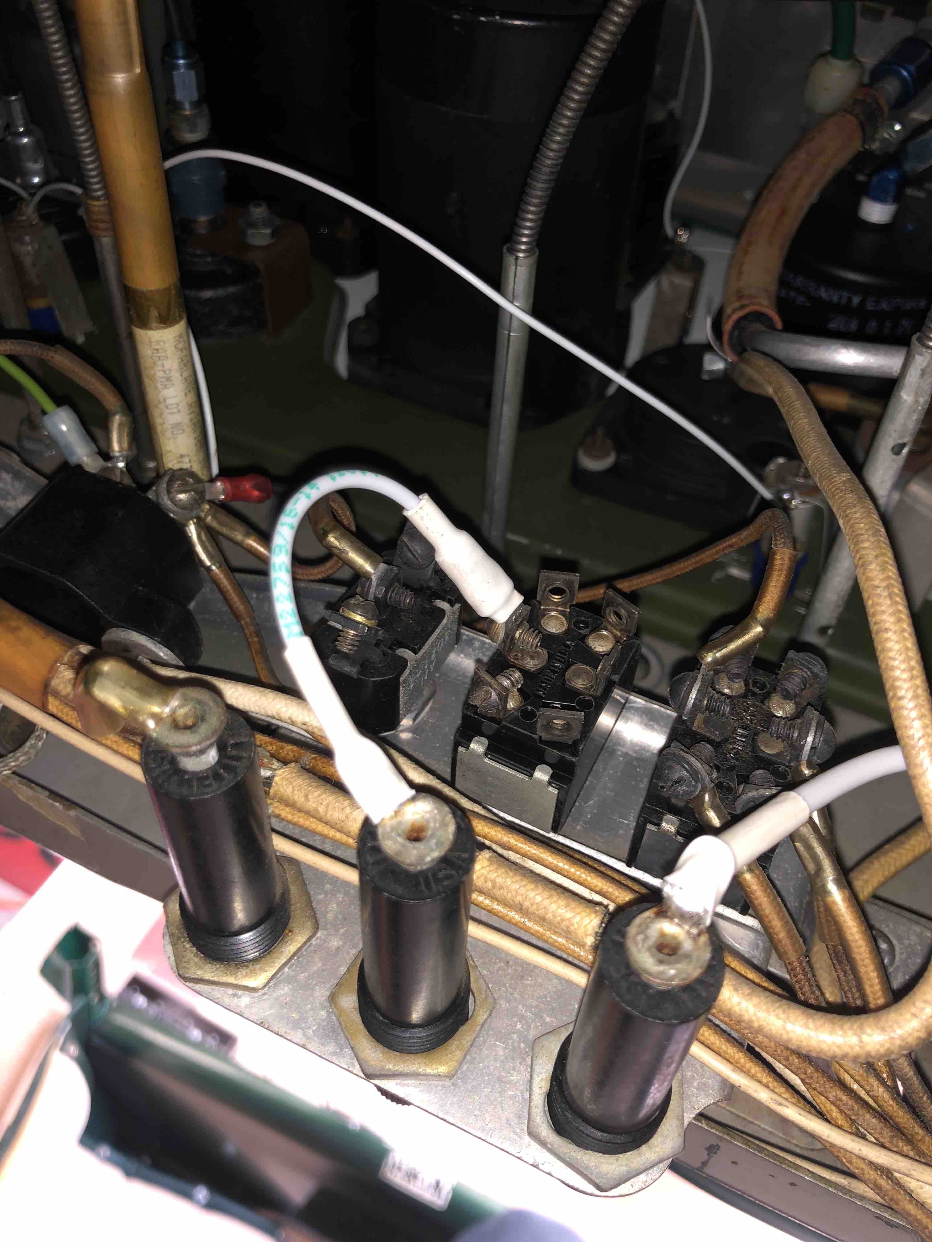

It is a Klixon CA-2 Circuit Breaker. 2 amp auto reset circuit breaker.

This breaker feeds the turn and bank switch in my airplane and has two other connections. I believe one of them goes to the stall warning system and the other I am unsure about. Need to do some more investigating.

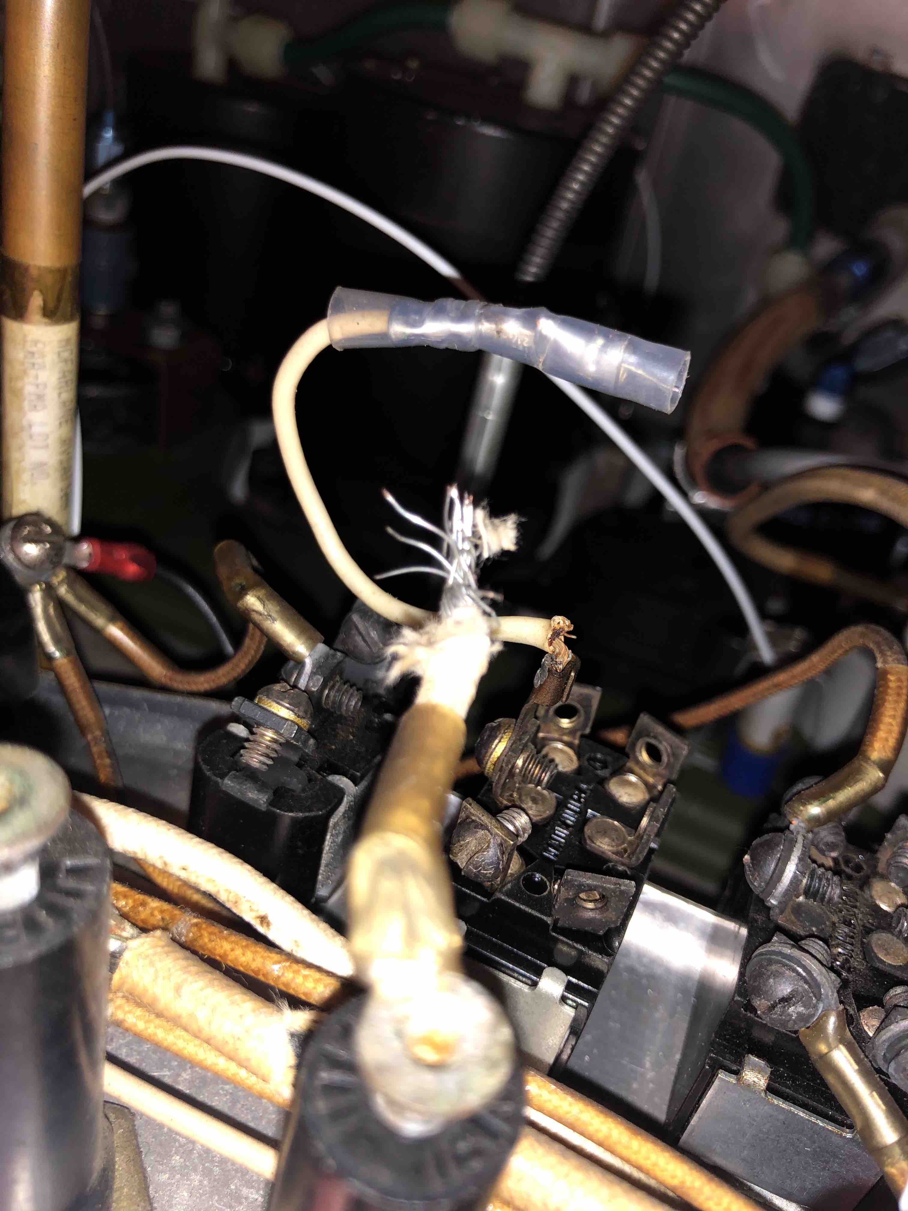

Check that green wire. It appears to be unfused. Circuits should be fused as close to the power source (that big wire with the solder taps) as possible.
elliotblock
Posts: 35
Joined: Fri Oct 25, 2019 4:01 pm
Re: Mystery Electrical Component
Post by elliotblock »
John,
That green wire (why did they use green??) was feeding the strobe fuse holder. I replaced it since it was frayed at the fuseholder. I would have liked to have soldered the new wire straight onto the main bus but my iron didn't have enough heat. Anyway, the wire was and is indeed protected.
If you notice, there is a black wire which comes off of that auto-resetting breaker. It goes to the airplane-right side of the instrument panel and up the wiring channel ostensibly to the headliner. I don't know where it goes from there... a mystery... maybe to the old dome light which is no longer installed? The other wire that comes off of the auto-resetter goes up the left wiring channel and to the stall warning vane (I believe). Still yet to track that one down.

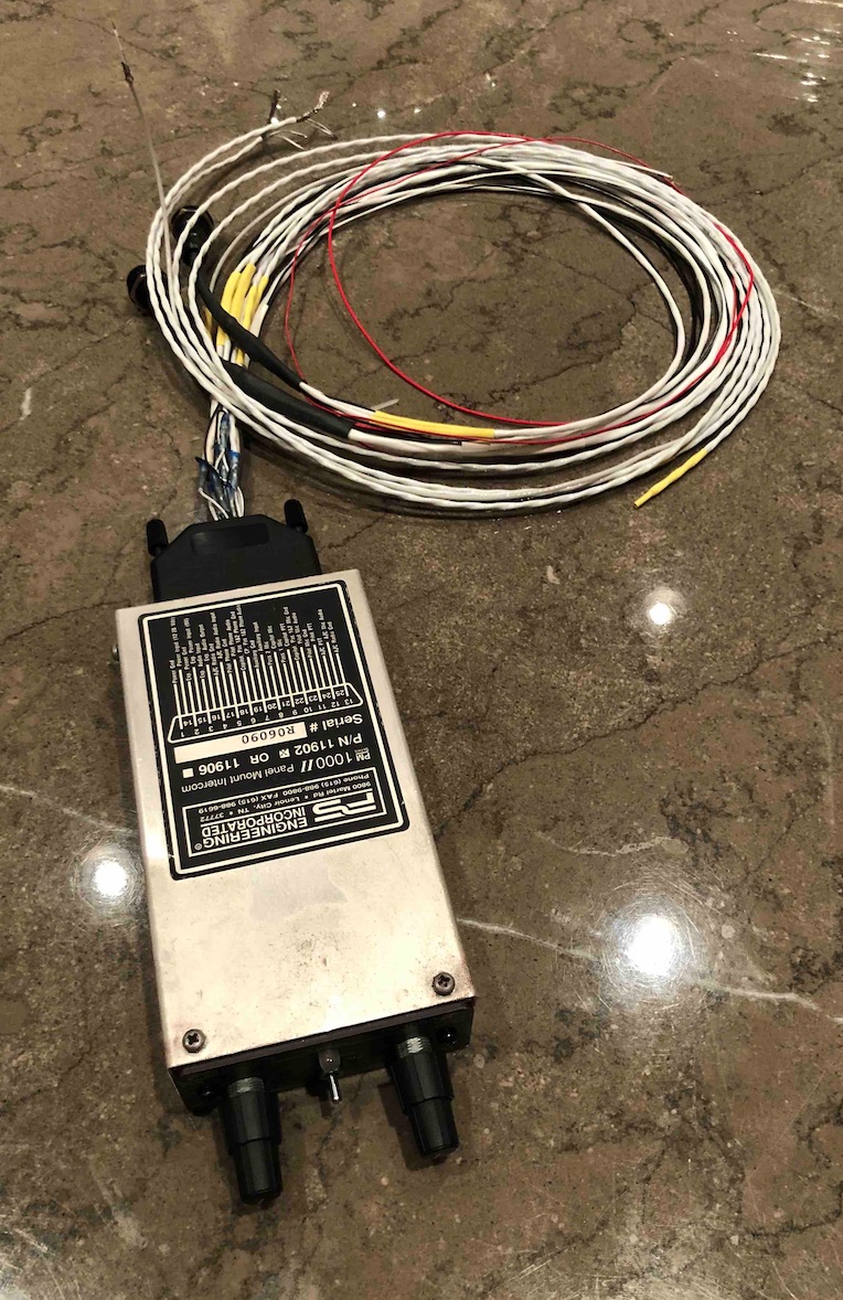

The airplane didn't have an intercom so I added one and made up a new harness for it with properly shielded wiring.
I capped and stowed the PTT wiring from the intercom harness for the pilot and copilot yokes. That's going to be another 'project' that I'll tackle sometime soon.
