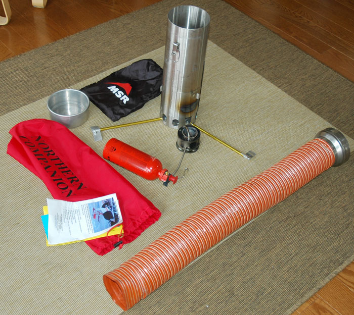

If you did get a copy of the Spring 2018 Newsletter, you will see an article (which I contributed with 2 other fellows) on ski flying. But you will also see pictures of my plane with my homemade copy of a Northern Companion heater on some explanation on pre-heating. I believe Continental has something written on preheating, at what temp and other details, but can't find it right now.
The attachment Northern-Companion.jpg is no longer available
Here's a copy of mine, I used also a MSR camping stove (multi type fuel - can burn 100LL if needed) and ventilation pipes. I carry it in the plane all winter in a spare foldable camping chair bag.. No electricity needed and a great survival piece of equipment (depends where you go flying)
Last night we had 14F and this morning 25F. We rarely fly below 5F, there is no more pleasure at that temp. The cabin is way too cold. It is very usual to have 5F in our region, and it is OK to be outside, you walk, you move...but in the cabin you can't move. But that is a personal limit, I have friends that fly at -13F, and it's OK.
All that to say, personally as soon as we have temps that are at around 35F or below, i use my preheater. With a good cowling cover (or sleeping bags will do), the preheater pipe on the sump, the heat will liquefy the oil (15W50) and heat will remain under the cowl and heat up all the engine block. Very easy to do, while you prepare the plane, do your walkaround. at freezing point 30 mins preheat will do, colder i leave it 45mins.

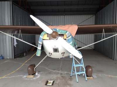

Post by 2135 »
I installed a Tanis Heater on my aircraft in 2012 when I lived in Northern Michigan. It is very nice to go out on a nice clear cold day and find the oil temperature around 75 and the cylinder head temp above 100. Starts real easy! The Tanis rep told me to leave it on full time; but I don't if I am going to be gone for a while. I also cover the cowl when I have the heater on. See the attached picture.
