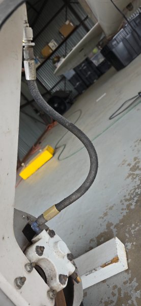

Ok what is the correct setup for these? I'm guessing a 45 degree angle at the caliper and then make shorter hoses? These hang out in the breeze and probably cost me 1mph

At least!
Mine have a 45 at the caliper. IIRC, the -10 in the part number indicates 10 inches from the centerline of the 45 degree fitting to the sealing surface of the straight fitting.

I agree it is probably over 1mph in cruise.
The new hoses and 45 degree fittings just showed up so I will transfer the ends to the new hose and hook it to the 45s. Haven't bled these before but I imagine there is some sort of ripple so maybe I will use the pressure bleeder I use on my cars.

Sounds about right. The end fittings add some length and I think I measured it at just under 12" to the fitting ends guestimating where the 45 fitting will connect.
