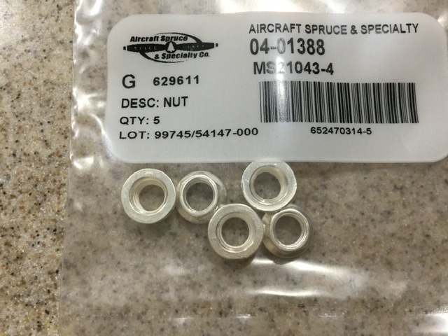

Here is the MS 21043 nut, same thing just silver plated as opposed to Cadmium plated.
Need to call Spruce in the morning I guess, I ordered and paid for 10, not 5.
Or just let it go.
