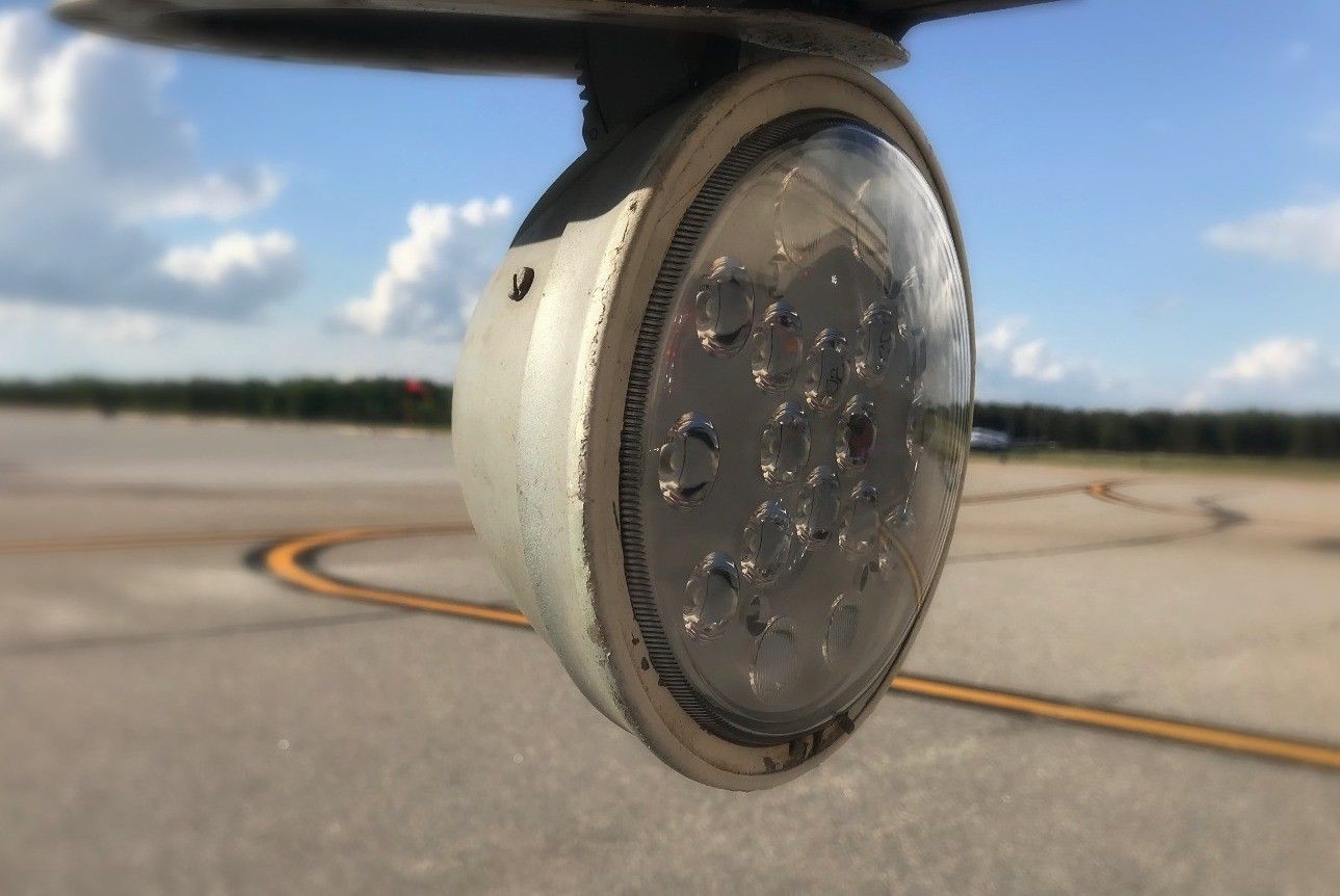

...now, replace the bulb with a LED and even a 5 amp fuse will be sufficient...more importantly, you can leave the light on in high traffic ;) . Mac
LED LANDING LIGHT AERO 4522 PAR 46.jpg (105.29 KiB) Viewed 96612 times

2066 wrote: ↑Sat May 23, 2020 10:01 pm ...now, replace the bulb with a LED and even a 5 amp fuse will be sufficient...more importantly, you can leave the light on in high traffic ;) . Mac
Is this a expensive bulb?
Happy flying. :D
Re: Grimes Retractable Landing Light
8466 wrote: ↑Sun May 24, 2020 8:19 pm
Yes. To me, anyhow. ...last I looked I believe the Whelen "certified" 4522 LED bulb is $328.00. Aeroleds markets one that is north of $600.00. Aero-Lites (Thomaston, GA) markets an excellent "drop in replacement" for $154.00, but the catch is that it isn't "FAA/PMA approved". Mac
