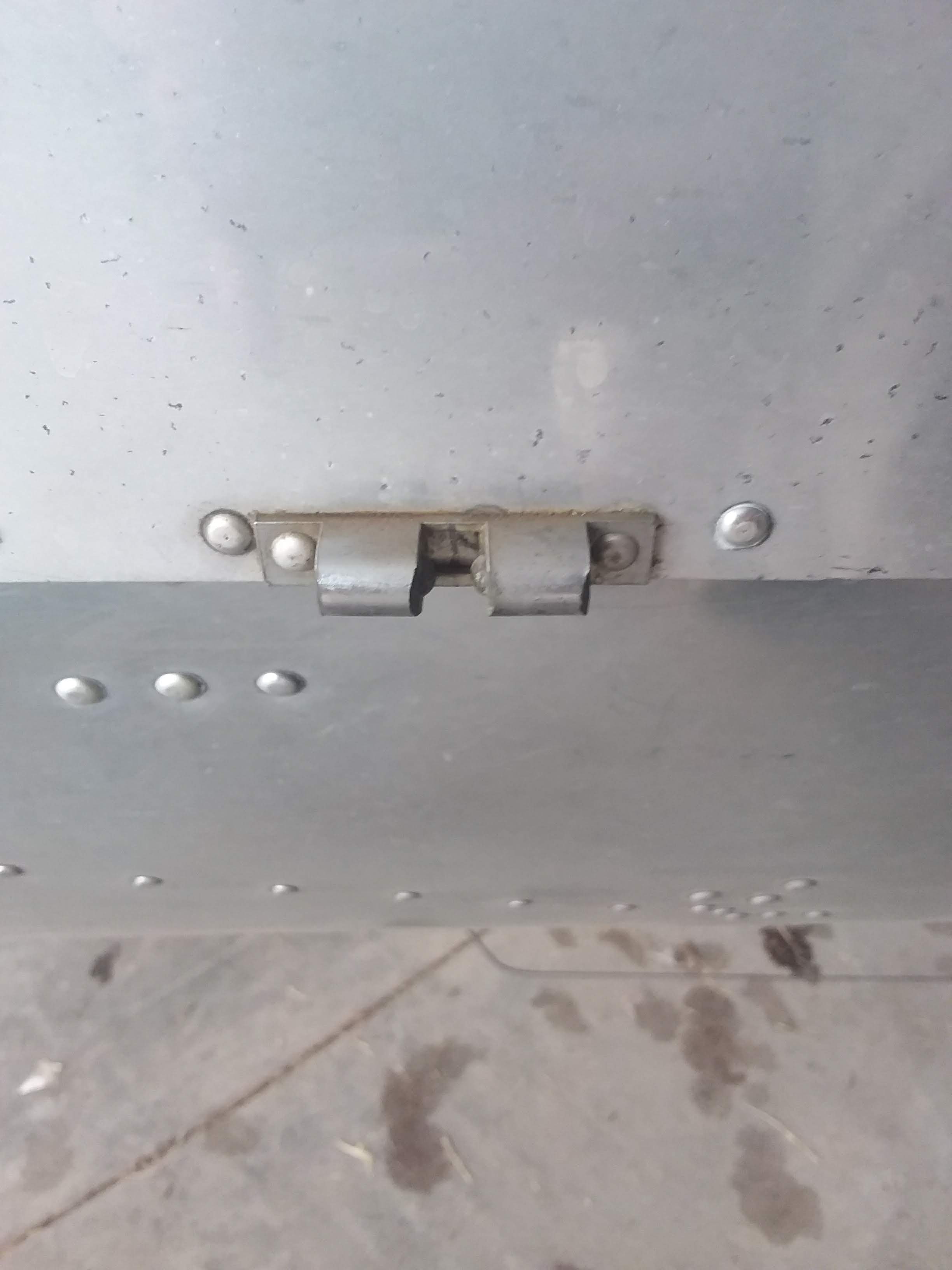

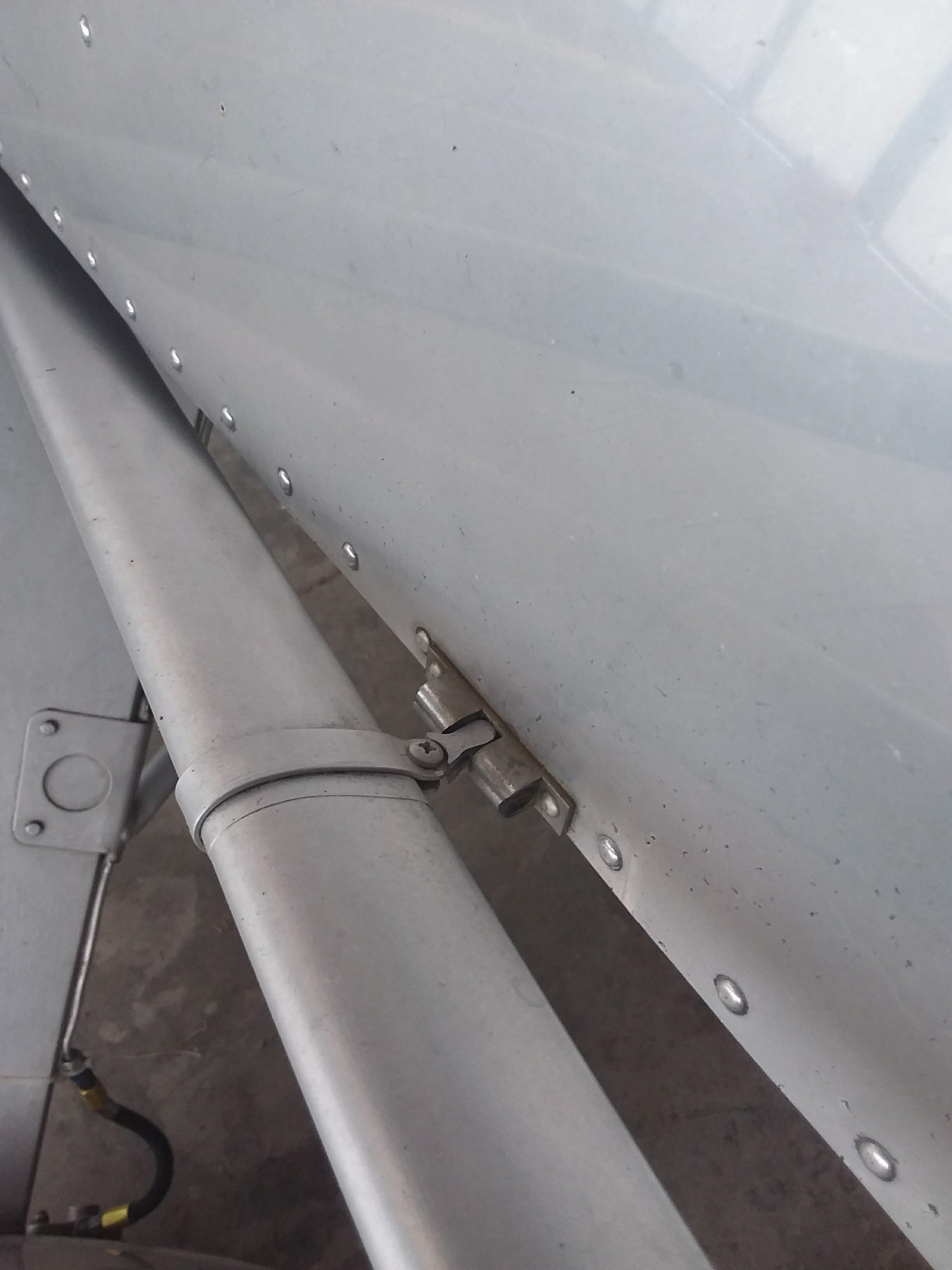

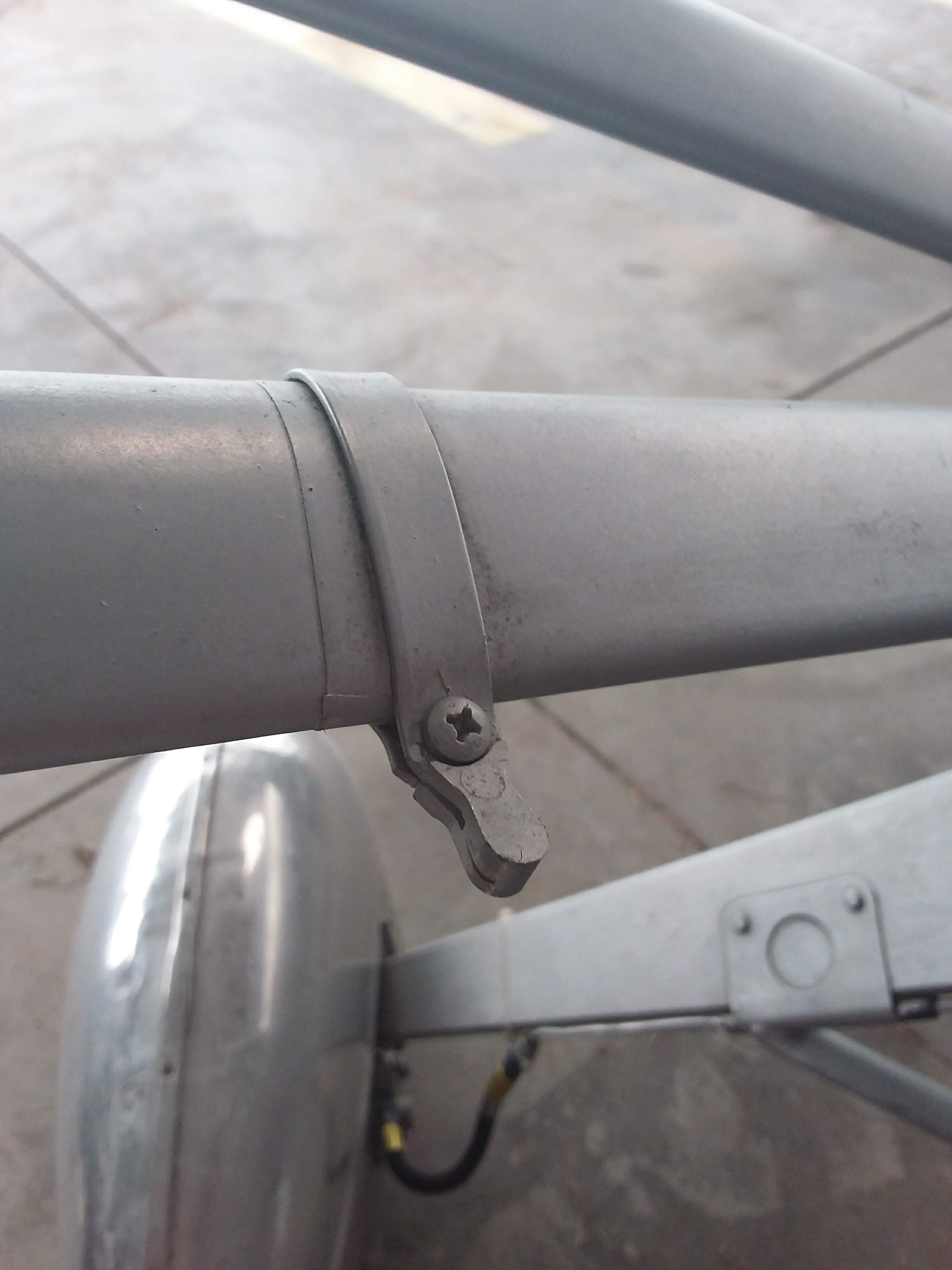

Looks like the "Sky Catch" must be what I have on my 140. Works well.

Yep those are the ones I have on my 140. My dad has them on his 150 as well. Work great and won't wear out in a few years....
