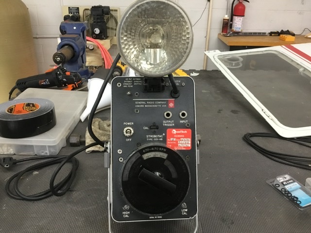

Ever seen one of these? it’s a strobe light tachometer that was used back in the day to see how fast anything was turning, this one was used by North American Rockwell to calibrate the aircraft tachometers of any aircraft made in the Albany Ga plant.
Yeah, I know I bet there is a smartphone app that does the same thing, but I like the old tools.
