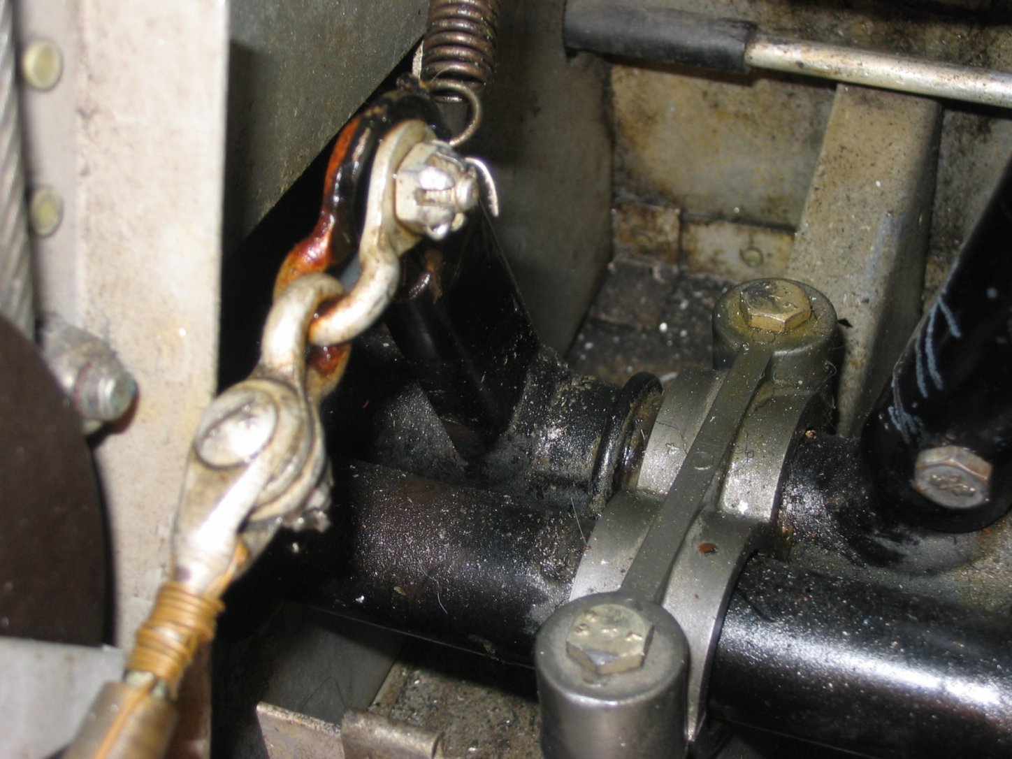

Hi Guys:
Well I got my replacement spring for the RH (passenger) side on my 140. I have looked and looked and cannot find a hole on the rudder assembly to hook the spring up. The old one was broken and hanging from the tab on the center console, it broke right at the rudder assembly. Any thoughts? (I don't have RH toe brakes....The pilot side has a clearly evident hole for its spring.....Any help or pics would be appreciated......Thanks.............John Sharkey 314 518 4818
- Posts: 562
Re: RH rudder return spring C140
Here's a pic of mine pre-restoration, I do have brakes on the passenger side.
Thanks for the pic it was helpful!....John
