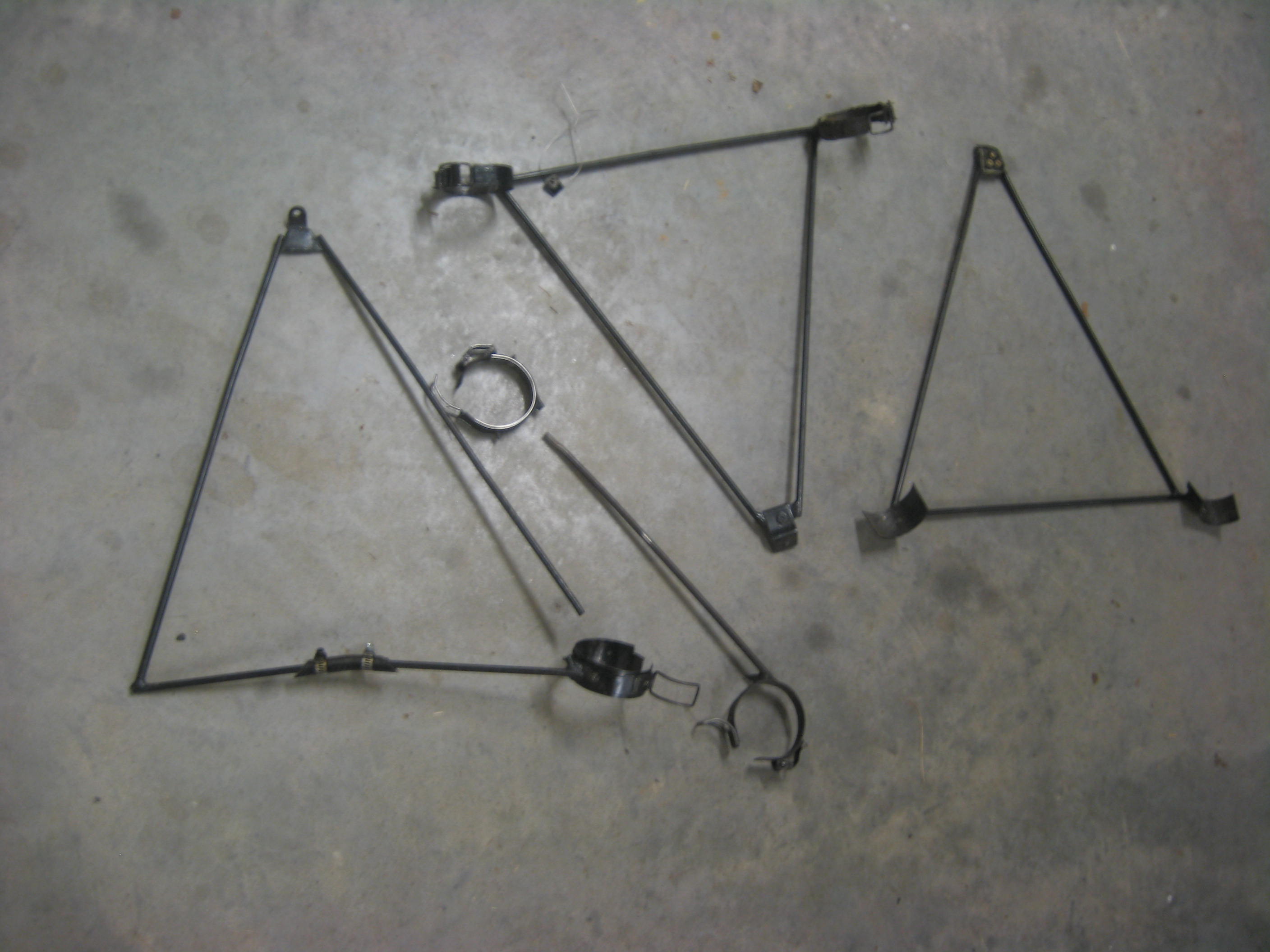

Posts: 2791
Re: Exhaust Bracket Cracking
2066 wrote: Mon Nov 09, 2020 5:39 pm One of our CA members, Still Chase, fabricated a bracket that included spring-loaded clamps & he reported good non-cracking experience -- I'm not sure, but his plans may be in our library (If not I may be able to retrieve a copy from "somewhere" :roll: )
Still Chase's exhaust bracket.
