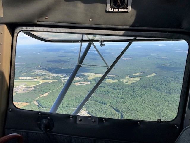

Re: flying with windows open
My passenger's side window was screwed shut and there was no latch when I purchased my 120. Later, I discovered that the hinges were in place, and the window swung open easily. I added C150 style latches on both sides and now open the windows in flight regularly. I also added a rubber strip on the outside of the lower frame in case it bumped the wing.
Maybe the best part is the fresh air while descending and landing on +90 degree F days. Hands down better than the original configuration.
I too wait until I'm cruising before switching to the open configuration.

- N76219 Window Open.jpg (86.1 KiB) Viewed 5826 times
