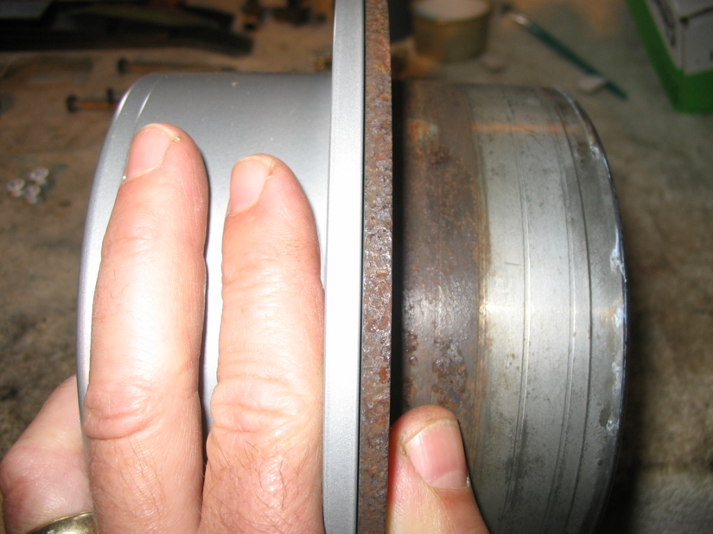

Do you have Clevelands? I had an issue years ago where my rotors had worn too thin and the brake piston would push out just too much from the brake housing, causing a few locked up brakes in the process. Clevelands have a table on minimum thickness' I can post if that's what you have.
- new&olddiscs.jpg (327.58 KiB) Viewed 5291 times

Machining the rotors so that they are smooth might be just a temporary fix and you might take off more metal causing the discs to be too thin. I have changed discs and pads several times and the discs always seen to develop grooves. It is most likely caused by dirt, sand, etc. that gets between the pads and the disc. I would check the thickness, I believe that 1/4" is the minimum for Clevelands on the 140, but I could be wrong on that.

The 40-97A wheel assembly has the 164-02601 brake disc, which has a minimum thickness of .205". I can't seem to attach the Cleveland files on the website(too big? PDF files?). PM me and send along your e-mail address and I'll forward this stuff to you.
