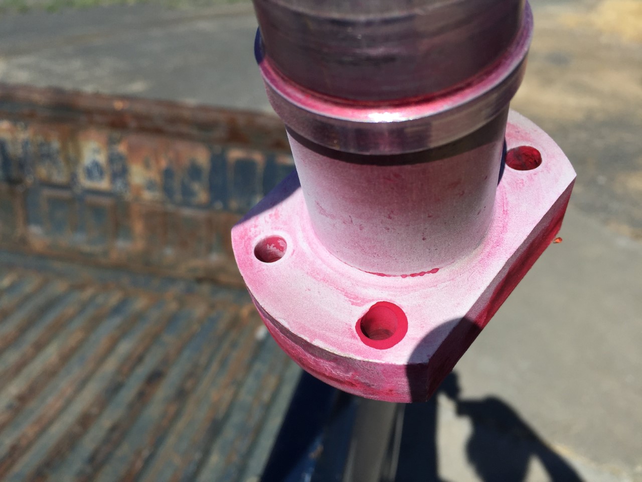

cessna 140 axle cracked.jpg (175.73 KiB) Viewed 1972 times
Replace them with grove the original axles can fail without warning and guaranteed wrecked plane. Here is one of my axles I didn't bother checking the other one and just replaced it. Grove p/n 5016-2, this is the standard size with the smaller 1/4" holes. $85.00 ea in 2018.
