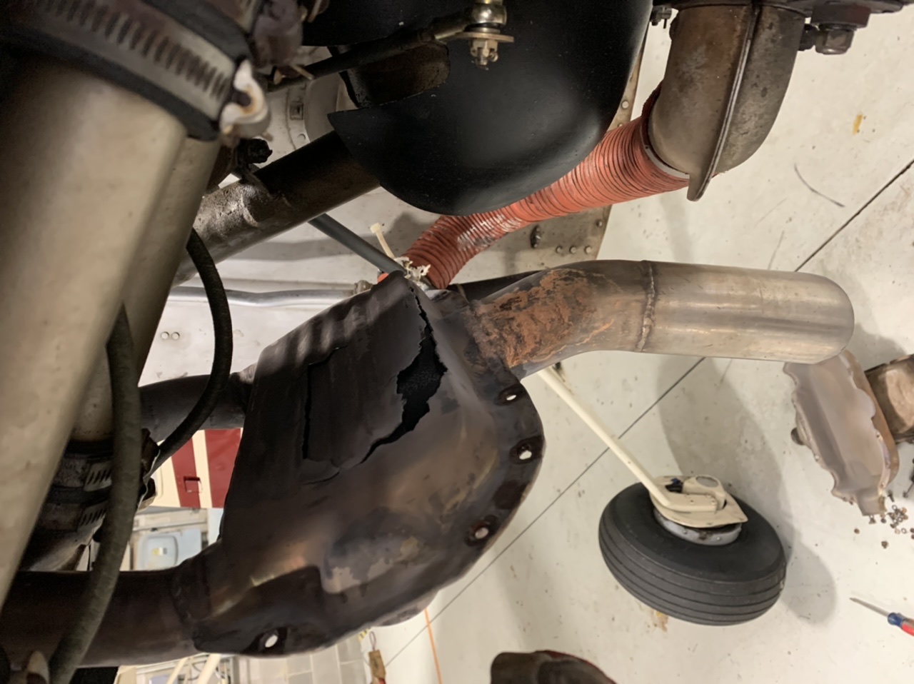

Big RPM drop with carb heat
At least the troubleshooting was straight forward. Time to replace the exhaust system...
- 818C15B7-585F-48E4-99F2-F116676DFDB4.jpeg (252.21 KiB) Viewed 5711 times

Re: Big RPM drop with carb heat
Isn't the what the make duct tape for??
Time for the 150 exhaust upgrade!
No, Rick -you get the big kit of JB Weld.
Yes, but be prepared for a long wait from Wag-Aero. I ordered in November and still waiting....
Hi mcidoug.
Not sure if this helps, but found these on Ebay.
https://www.ebay.com/itm/Lot-2pc-Cessna ... SwJ4peVGZu
21 hours to bid. 0 bids. minimum bid $199.
Steve A H
FA dodge can set you up with a great set..... and if you need the 150 support bracket I might be able to set you up with a guy that can produce one.
I replaced my older 150 exhaust I purchased used in 1997 last year. Took it to Aerospace Welding in Eagan, MN for repair, they said it was toast. They put a new system together in 3 days, all components have part and serial numbers on them with the appropriate paperwork. I'm very happy with the installation and recommend them for all exhaust system needs. TO
I might have to look for another option as Wag just told me today that now its end of March for mine......
Your photo is a great example of why the pancake mufflers have an inspection AD on them. Now if that had been the cabin heat side.....
