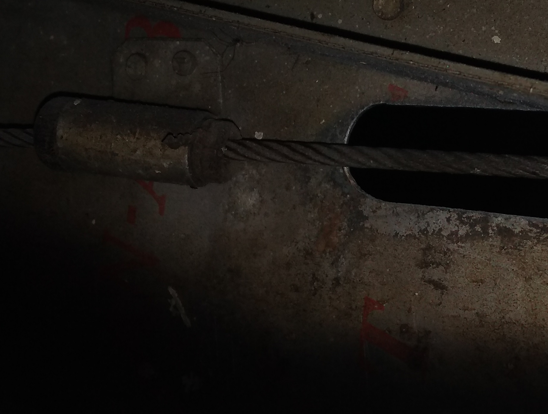

Its a P shaped bracked close to the rudder cable exit slot. The circular section of the P shape looks to have a paxolin bush in it that is flanged at one end to prevent is pulling through the P and a safety wire at the other preventing it coming back through the other way when in normal use..
I am assuming that the bush is split to allow it to fit over the cable (as the new McFarlane cable doesnt have this bush fitted already to it) but I cant see a way of getting it off..
If I remove the lock wire, should it just push through? It doesnt appear to move when pushed but could just be tight with dirt etc?

It's been a few years, but -- yes, it's in two pieces/split and it'll "slide" out...BUT is likely cinched in there pretty tight in addition to the safety wire "holding" it. I took that opportunity to remove the horiz. stab for access -- not a big deal, incidentally, and I realize you may already have adequate access(?). Hope the pic will help. Mac

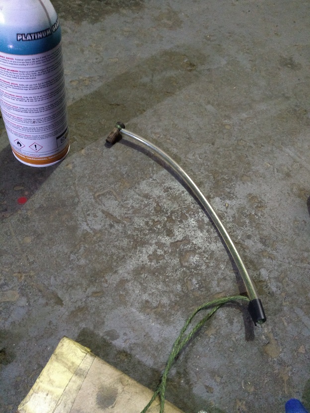

I did the usual stuff of removing the pulleys and attached cord to the old cables and pulled it to the bush in the tail. At this point I removed the safety wire loop at the end of them with a pair of long nose pliers... I had a look at the bushes and assessed how or if they would move by tapping them with a flat ended punch... Gently I may add... Nothing happening, based on your comments on how stiff they are.. So I cut the old cable off and pushed the cable back through the bush with a punch of the same diameter... Using the same punch, whose shaft diameter was just smaller than the P section of the bush holder, tapped the bush until it started to move.
Using a peice of tubing and cord I made a "snake catcher" and used it to put a holding loop around the protruding bush section and pulled it tight just so the bush doesnt fall into the fusalage. Once this was in place i continued to tap the bush out. I forgot to say that I am using the slots in the rear fusalage where the rudder cables exit to gain access.

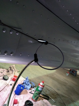

At this point I pull in the new cable with the aid of the cord. When in I pull a good loop of cable from the back of the P section (fusalage end) through the cable exit slot so that I can put the split bush onto it and use the snake catcher again to hold in place... Grease the outer of the bush so that it goes in a little easier than it came out and push the cable back into the fusalage... Using the snake catcher from the opposite side I can, with some fiddling about get the bush in place at the reqay of the P section...

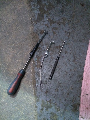

This is where it gets even more fiddly... Invent a new tool called a "scranner" which is a 3/8 spanner taped to a screwdriver for length... putting the C of the spanner over the new cable I could gently push against the bush to start it going into the P section.
Invent a new tool with no name, but basically an old flat steel spanner that came with some flat pack furniture, bend it over at the end and cut through to make a C end... Its too short so attach some thick safety wire as a pull...
Another very fiddley bit, but put the modified flat spanner through the cable slot and hook it over the cable close to the rear of the bush and pull the bush into the P section...

- Tools used including "Scranner"
- tools.jpg (68.59 KiB) Viewed 4748 times
- Snake catcher & bush
- snake.jpg (218.75 KiB) Viewed 4748 times
- New cable loop
- loop.jpg (48.89 KiB) Viewed 4748 times
