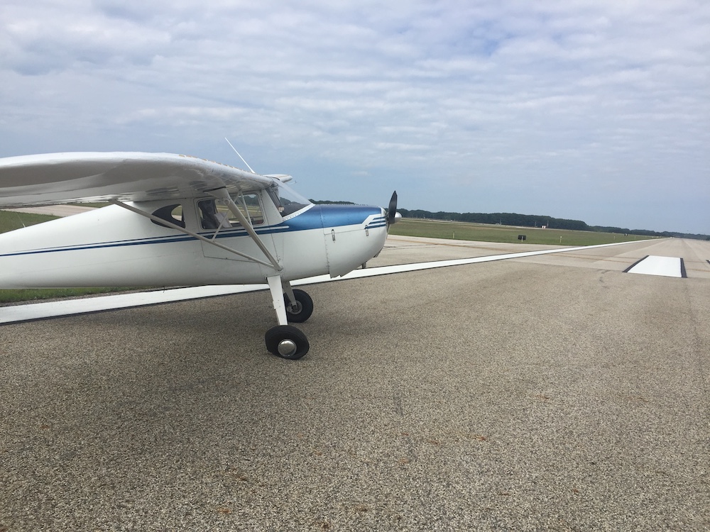

I've been running around 20psi. One thing I will say is check em now and again with a gauge, as a visual check doesn't cut it. I checked and they looked fine. Landed and blew a tire, when I checked the other side it was down to 12-14psi and looked fine... I'm lucky when the valve stem sheared it deflated slow enough it wasn't flat until taxi speed... Came damned awful close to a ground loop that no amount of brake could have prevented if it went flat faster. Good reason to remember to land as slow as possible too...
