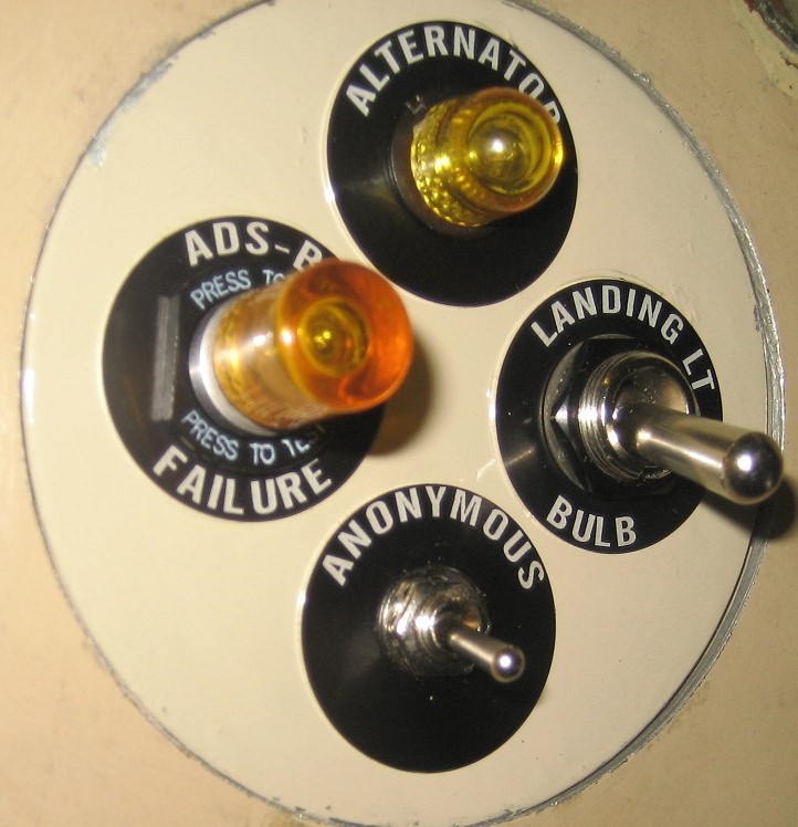

Sam wrote: ..."Next, Has anyone altered the light on/off switching to make it independent of the stop? Is this a good idea?"
Sorry I can't answer the other questions...it's been awhile since I've been into the light assembly. I can answer the switch query, however -- well, kinda ;) . While we didn't alter the internal wiring for switching the bulb on/off at any position, we did add a switch for when it's fully extended and normally "on" continuously. And -- yes, in my opinion, it is a good idea as I can now leave the light extended (if desired) & easily control a 4522 LED replacement bulb as desired without killing the battery or waiting for the light to extend. (Plz don't look too closely at my grungy panel paint...another "next project" :roll: ) Mac

Thanks for this. I can extended my lights to the stop then the light comes on. Then I can retract a bit to turn them off. Again, putting the switch into the extend position to get them to turn back on. So hopefully I can find the optimal down position with the adjustment if needed. I just installed the Aero-lites LED Fusion 46 on both sides. Wow, what a difference!
Now I am contemplating getting rid of the generator? I see you made that mod. What are you thoughts on that? I have an O-200 with a vacuum pump but still the old generator.
