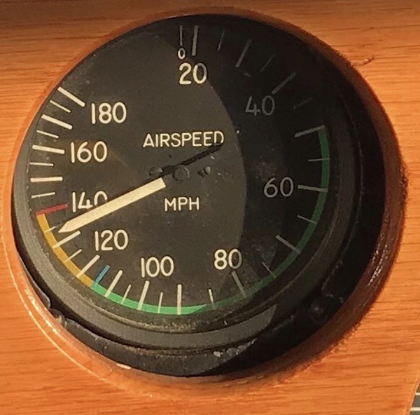

This is mine, not sure if original, but the numbers appear to be correct.

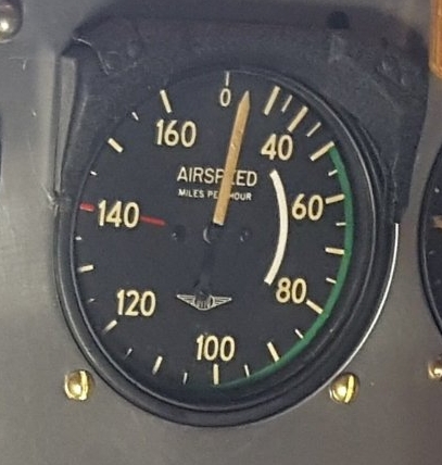

Something like this...

I have several photos of panels, and the most original ones all have ASIs that top out at 160, like the one above. The one I have that's a copy of an early sales brochure, is not readable, of course.
