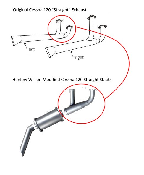

I have ( I hope ) found a company in the UK that is making the top part of these
Which are the Henlow Wilson modification to the original straight stacks. The Mufflers and lower pipe are in good condition but the exhaust down pipes need replacement - they are using the originals as templates as the drawing above is not accurate for the P2 side ( right ) arrangement of stacks. When they are done I will post a picture. The company are reputable aircraft exhaust fabricators and the new stacks will come with the necessary paperwork. Happy to post a picture of the finished items when they are back with me.
The nice thing is this will keep the "bark" of the exhausts that are currently fitted.
