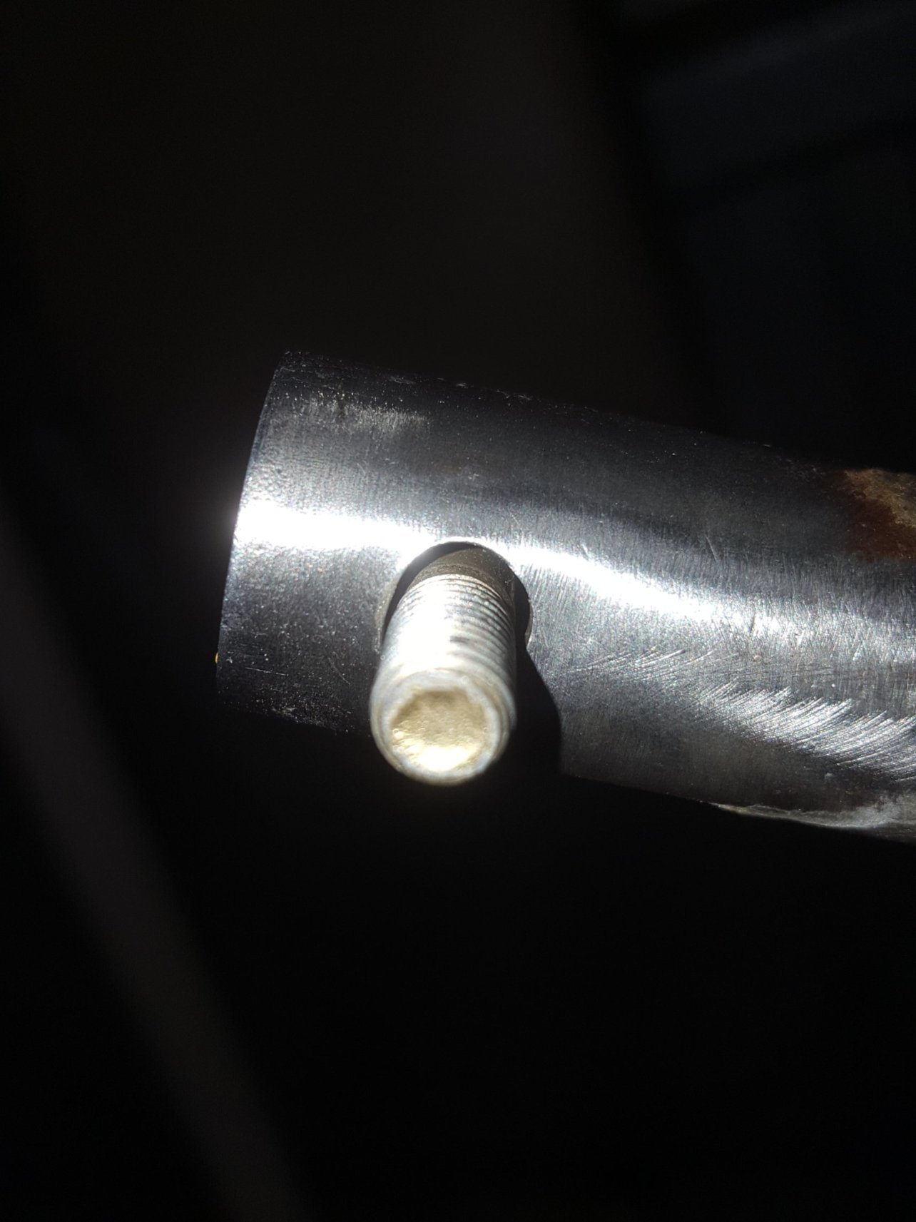

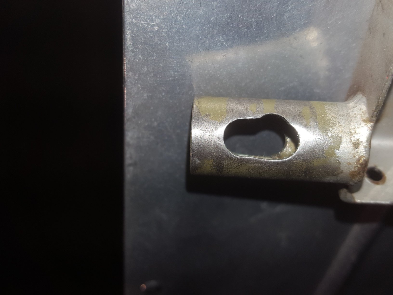

Just an additional follow up on the subject-
Local bird with a floppy right flap, Model 140. Made a new torque tube out of .75 x .065 wall thickness 4130 and installed a new U0425118-1 right flap fitting. Previous mechanics simply squeezed the torque tube over the flap fitting to keep it from flopping. It was dropping some 5 degrees when I undid the tension. Here are the culprits. Was an easy fix...
I'm guessing this somewhat common malady has something to do with the flap bellcrank being offset to starboard on the torque tube.
