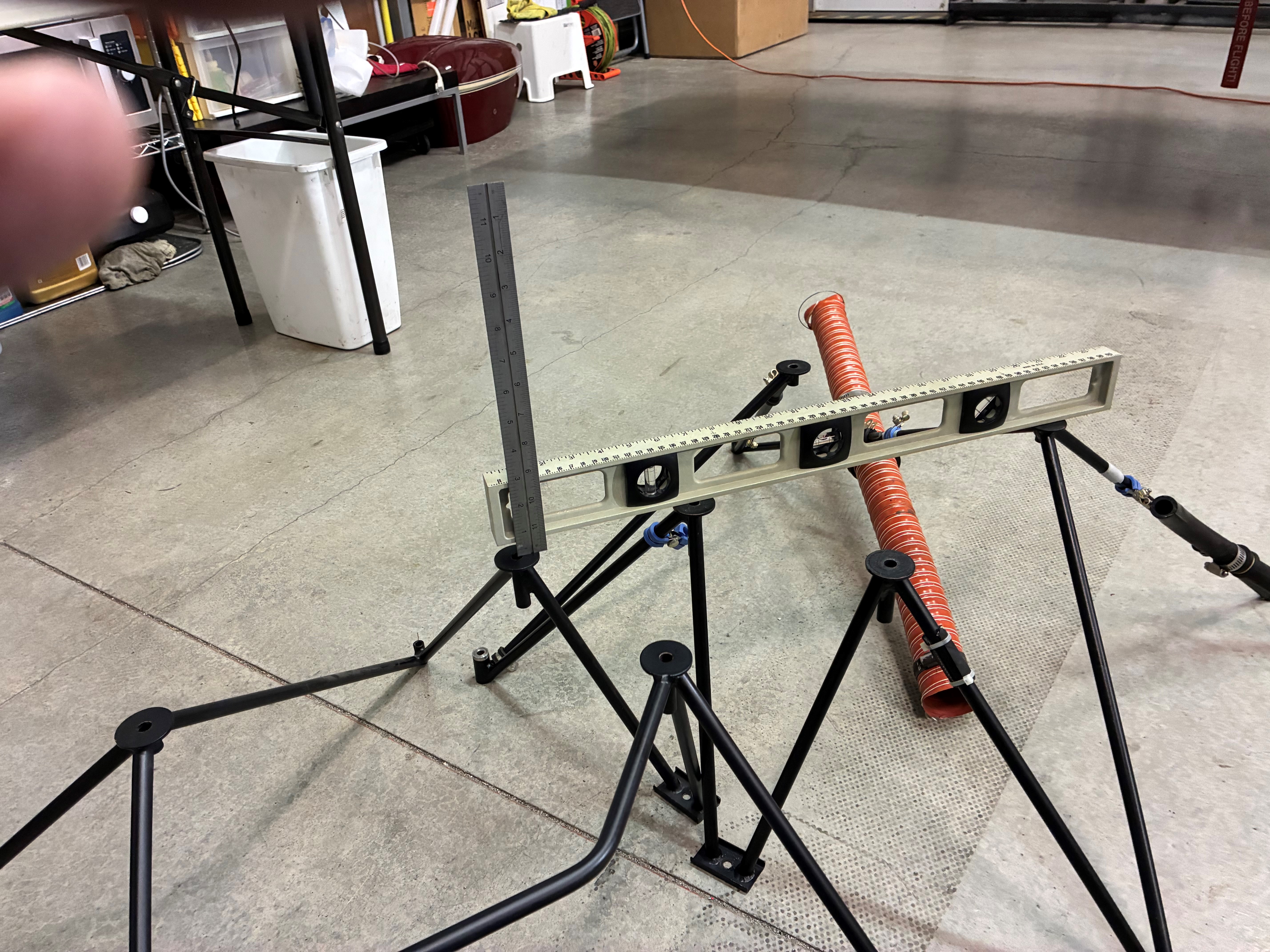

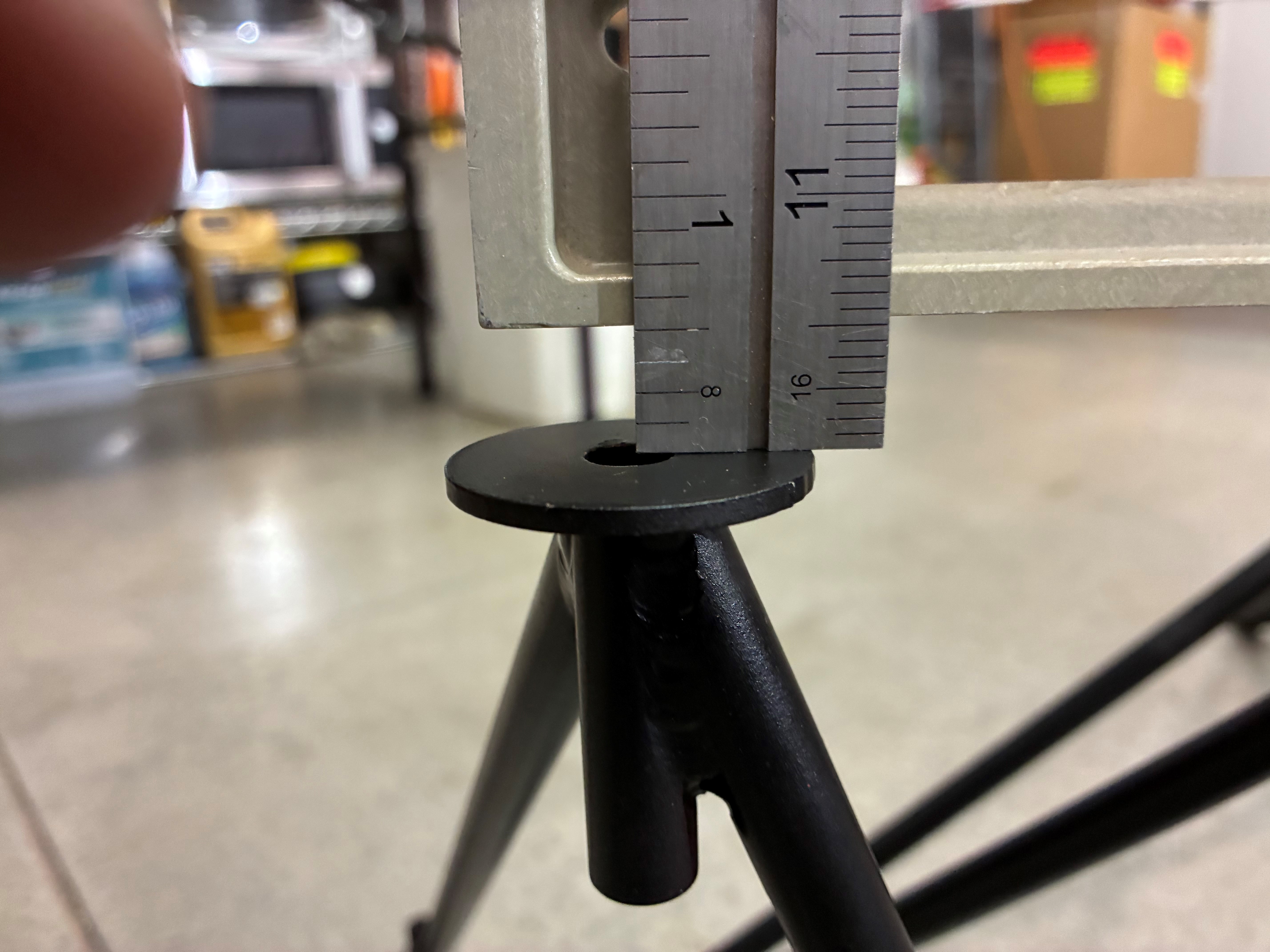

I went forward in getting the 0451111 "proper" mount ( for the C90-14F engine I have). There is indeed a 1/2 inch difference in station value. See attached photos 0451000 mount next to the 0451111. I placed a level on two of the mount pads common to the "taller" 0451000. I extended the level over one of the same pads on the "shorter" and used a scale to show the difference.

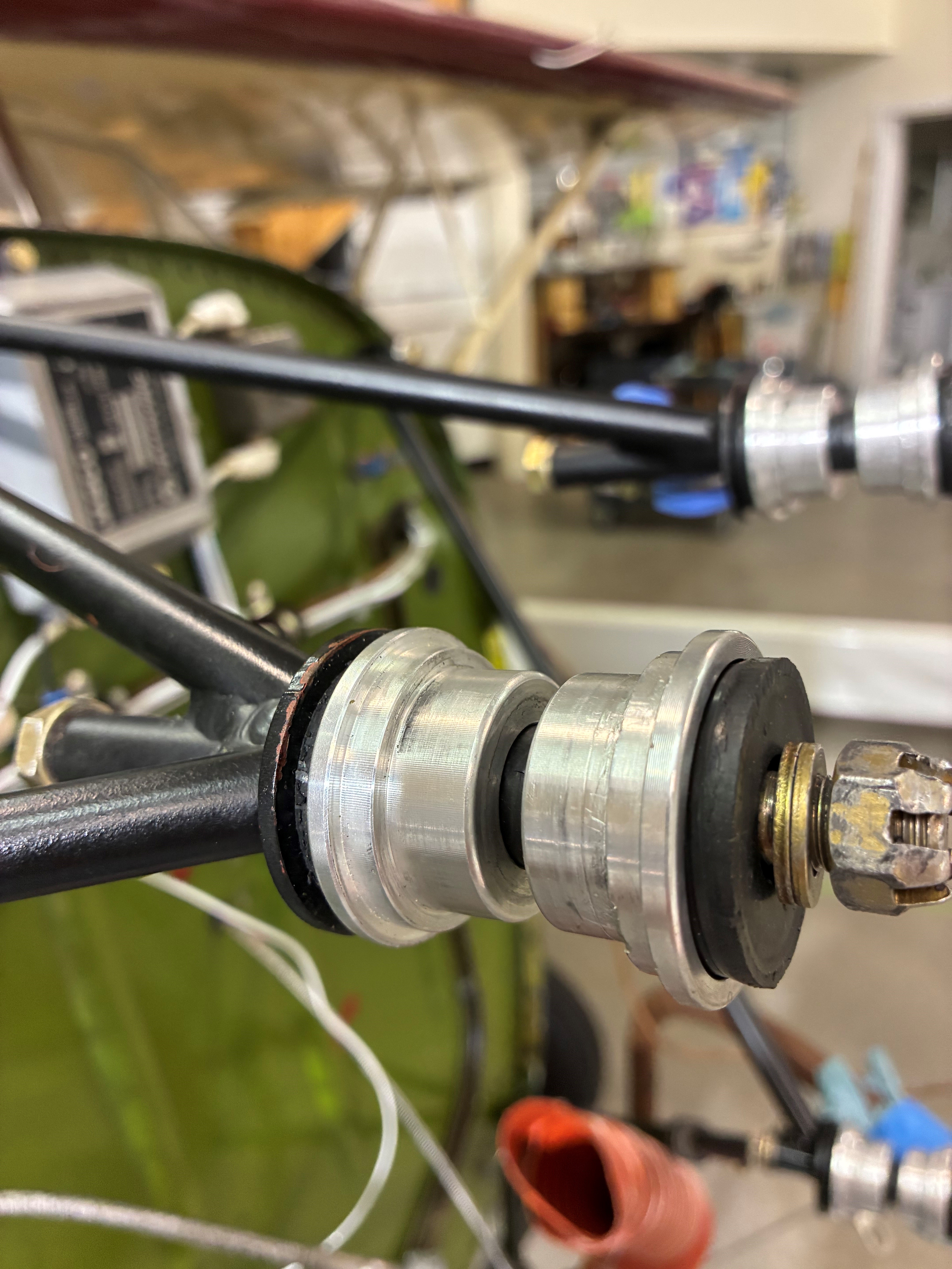

I came across a used a set of a " conversion isolators " to install the -14F engine I have on the 0451000 mount. I could not find any substantiation data to present on a 337 and was not confident in the vibrations I might encounter. So I gave up on the idea.

Photo three shows the adapters I was referring to. I recall that Don Swords had some sort of approval for them, but I could be wrong.
