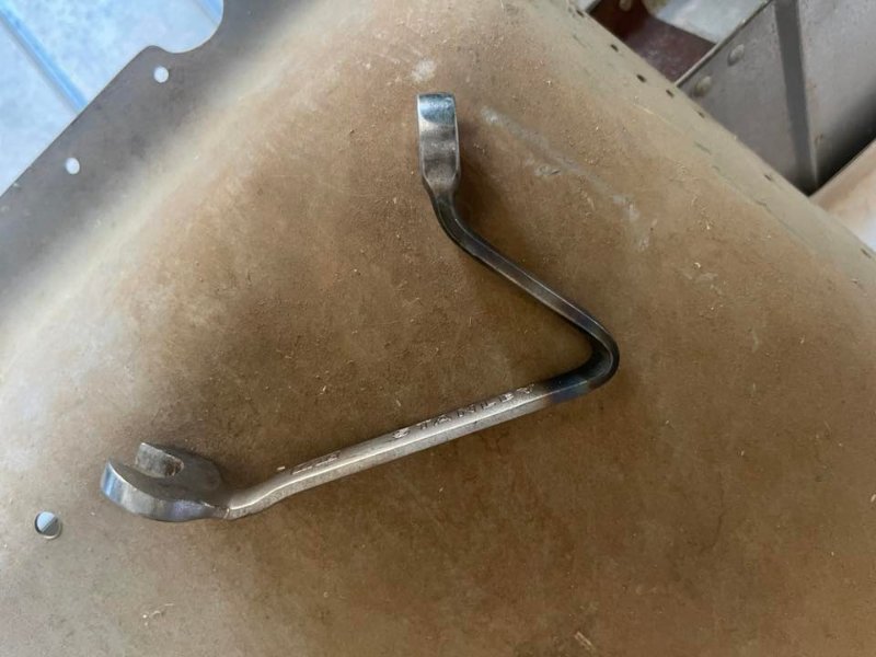

Now if any of you fine aviators out there have some good pictures of this tool modification that can be used to loosen/tighten those pesky nuts on the horizontal stabilizer without crawling down inside the fuselage, please post it. That wrench gizmo/contraption sounds so much better than trying to convince your youngest child or young grandchildren to walk/crawl down the interior of the fuselage to hold a wrench or socket in return for an ice cream Blizzard at Dairy Queen. That payment method doesn’t work very well these days for those youngsters.6597 wrote: ↑Mon Dec 08, 2025 10:20 pm The front nut/bolt can be tightened with a bent closed end wrench thru either of those access holes, I think I took a torch to a cheap box end wrench and bent it to what I needed, simple enough. Do not over-tighten. Here's what the bolt hole looks like on the fuselage sans vertical fin and horizontal stab...

Re: vertical stab wiggle
Randy Thompson posted this on the Facebook group, but I have no idea how it works.
