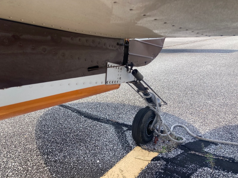

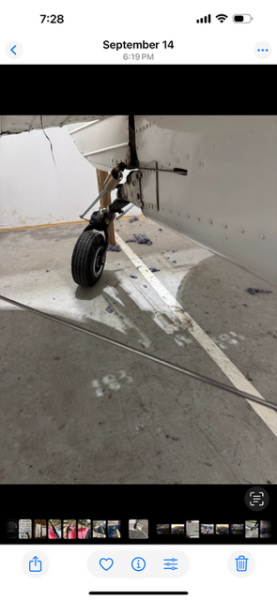

I’ve attached three images. One appears to have rivets, the others have bolts. One person I spoke with said that the bolts would be easier than Rivets to install-but that neither one would be easy.

Re: Fuselage reinforcement with Scott 3200
