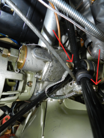

OK, you got me thinking...Anyone have a photo of where their bonding strap runs from and to?
I recall seeing the washers with tabs about 40 years ago. they're probably in a bucket of old hardware I have at the hangar... They were worn and the IA I was working with fashioned a jumper with about 6 ga. wire and ring terminals. It goes from the stud on the engine case opposite the one the oil filler neck support bolts to, to under the head of the engine mount bolt.
If you have the washers, there should be 4 of them. If you only have two I'd definitely fashion the jumper and fly worry free.

OK thanks. There are four of them, but the tabs contacting the case have broken off of two of them, so I wanted to replace them all. I can see that Cessna still sells something similar, but it has a larger center hole than mine do. The wire with ring terminals sounds like a good solution, though less redundant. I will see if my IA will accept the jumper idea. I suspect these washers were original parts that the installation shop just reused and the tabs failed over time on the lower ones.Anyone have a photo of where their bonding strap runs from and to?

Have another one on the other side, plane came with 2 so I did the same. 0-200.Anyone have a photo of where their bonding strap runs from and to?
